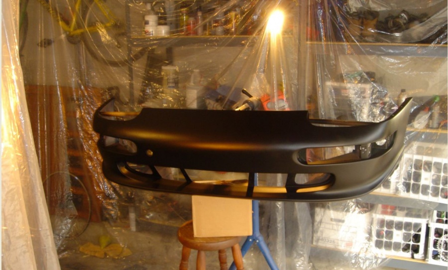

It looks like you are taking the right steps with prep..... just get a nice HPLV and compressor. Make a "booth" out of plastic sheets, and go to a body shop supply and get a respirator, and paint/solvent/clear. Ask them for mixing instructions for the temp / humidity you will be spraying in.
Here is a pic of a TechArt 993 Bumper I did years ago (in my garage). Looked like a factory spray, when I was done!
