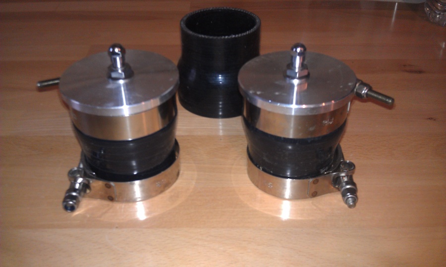

Just bought a pressure test kit from Marski so it will be put to good use.
What is in the pressure test kit exactly? And how much was it?
Pictured is the kit I got from Markski. Very high quality and works very well. The two items with the clamps plug each turbo. The coupling in the back is for pressure testing from the TB.
Also on his webpage

Minus the clamps seen in the
picture. I received much different clamps, they seemed to work fine.
