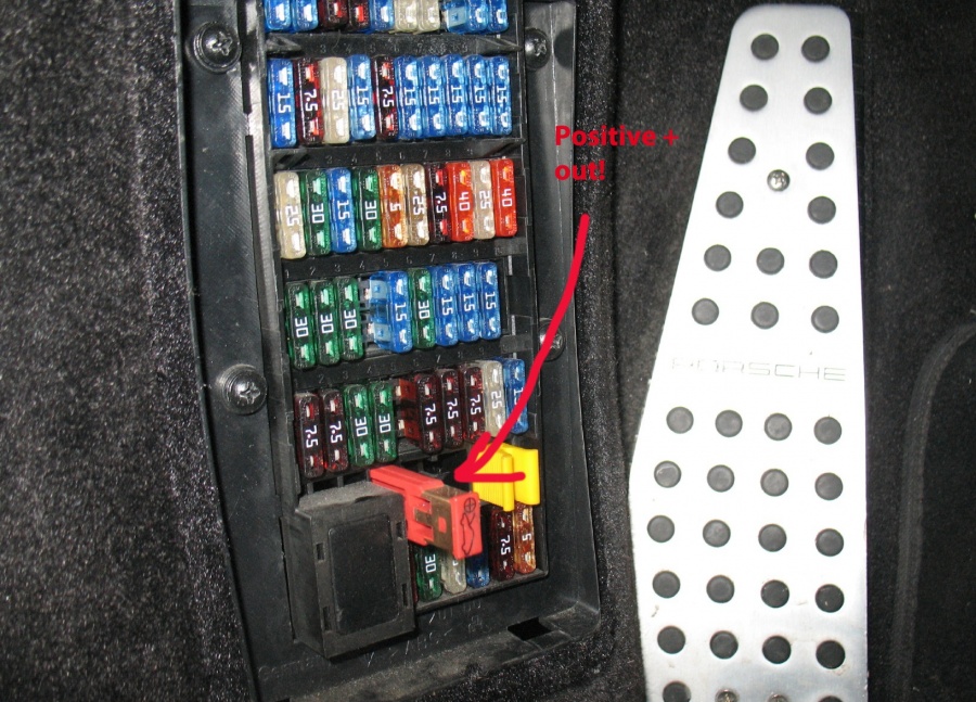

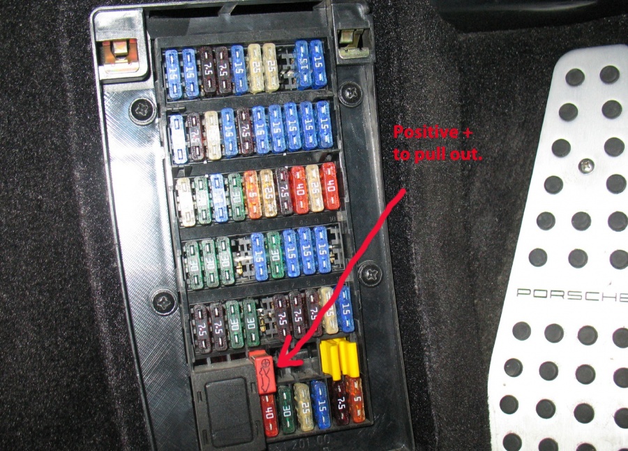

Pictures I took just for you !

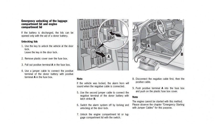

Location of the fuse box. Location of the positive post (terminal A). Location of the positive post (after pulling it out)....On the second post you will found where you should connect your negative (the door hook or latch striker).

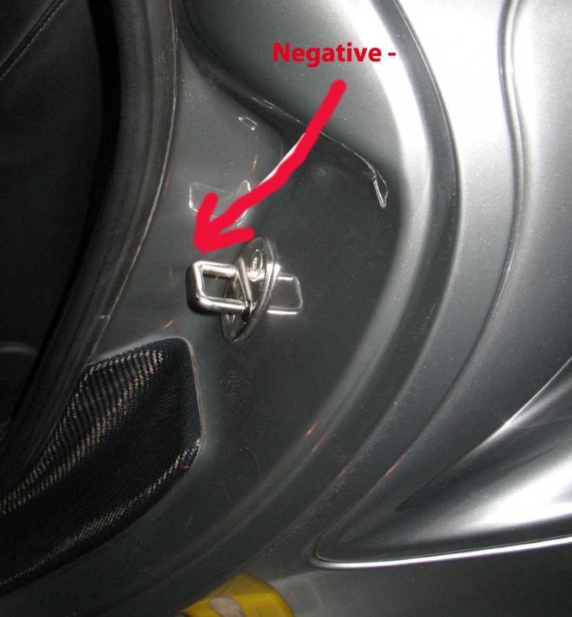

Here is where you should connect the black or negative of your external battery. The door hook or latch striker. (terminal B)

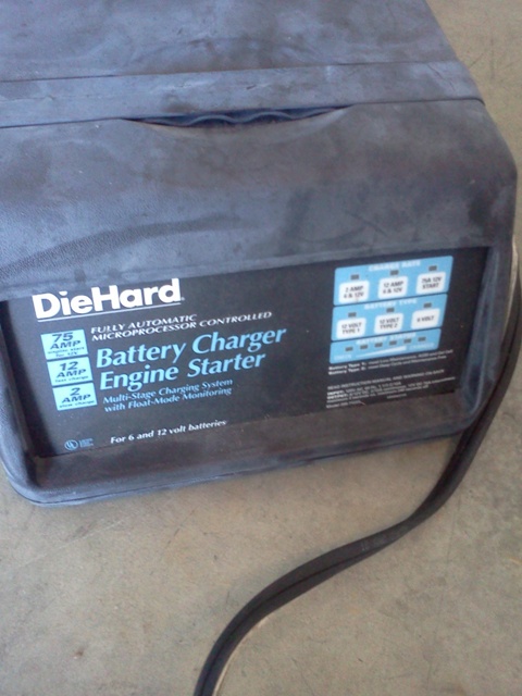

Anyway, tried using one of these and after hooking the cables up, nothing happened.
I used the stting that read (75 AMP/12 Volts/jump start) and still nothing happened.

I think you should get a battery with jumper connected as per previous post. May be your battery tender does not supply enough amperage to get the hood to open. The key is stuck ????

Obviously you don't have a second key..... The other choice you have is to found the cable release behind the front right hand wheel well cover....See pics post #7....I am nervous when you say "will not start" I hope you mean will not open. Because this red post in the fuse box should be used only to open the front bonnet to eventually connect a battery charger to the battery.... The key is stock in the door or the ignition?
