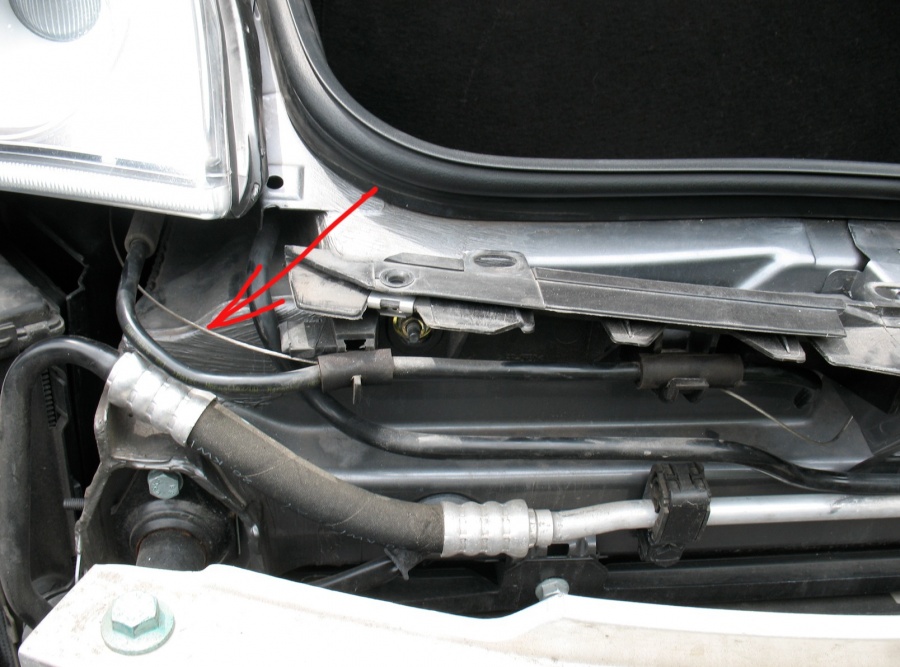

anyone have a pic of the trunk release cable

This is a picture with the bumper removed. It is a steel wire and you have to pull really hard to open the bonnet. You can reach it from the right wheel housing front area....Hope this help.

It is a pain in the rear end to reach, I did it on my dads 2002 turbo, it is on the passenger side and you have to reach over the tire way up into the wheel well along side the trunk. You can feel for it pretty easily and you have to give it a good yank to get it to release the latch. Good luck!
