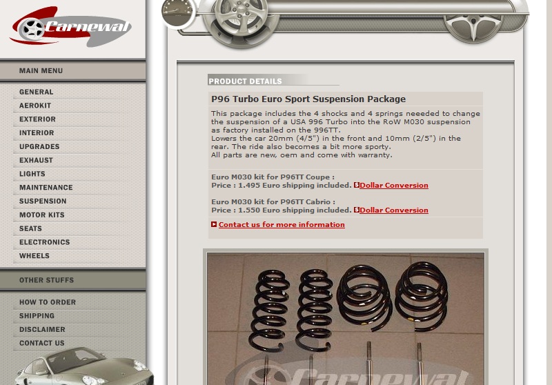

www.carnewal.com is a good candy shop for a TT owner:

So that means that M030 is standard on European models only?
Yes.
I have a set that just came out from my car when PSS10 coil overs went in. My M030 have 50kmiles, other than that they are in good shape. I will sell them cheap!
