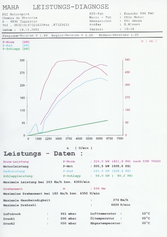

This is what a standard turbo dyno looks like

Originally posted by PorschePhd
On mine and Garrett's Dyno yes. We have huge drag and loss.
You are correct Neil. The MAHA will allow a rollback calculation which gives actual drive train loss and calculates crank numbers
Hi Stephen. I have always wondered if the rollback
measurement of drivetrain losses + measured at-the-wheel
power, has ever been compared to a real at-the-crank dyno
room measurement to see how close the real running loss is
to the spin-down measurement. The reason I ask is because
some of the engine power drain is due to the compression of
turbocharged cylinder charges, and the piston sidewall friction
during the combustion downstroke. During a spin-down measurement the motor is off-the-gas (maybe it should even
be turned off?), so the pistoms are not having to compress as
much of a cylinder charge as when they are at max HP, and
the sidewall friction is also lower, so I'm thinking that the spin-
down resistance is less than the real loss when the motor is at
work.
On the other hand (I'm thinking while typing...) if we want
the *drivetrain* loss (everything beyond the crank), we would
want the spin-down to have as little resistance as possible
from the motor itself. Ideally we'd want the dyno momentum to
turn everything from the wheels to the crankshaft, but nothing
more. Ideally the motor should be severed from the crankshaft!
The internal motor friction should be taken out of the equation
because it has it's effect before the power is delivered to the
crank anyway. Maybe that's why it's good to do the spin-down
with the car still getting enough gas to idle, so it adds enough
power to mostly overcome the internal engine friction. I guess
the most accurate spin-down test would be to first map how
much throttle is needed to keep the motor spinning in neutral
at every RPM in the dyno test range, and then have that amount
of gas delivered during the spin-down so at no place was the
motor itself slowing the drum down.
Joe
