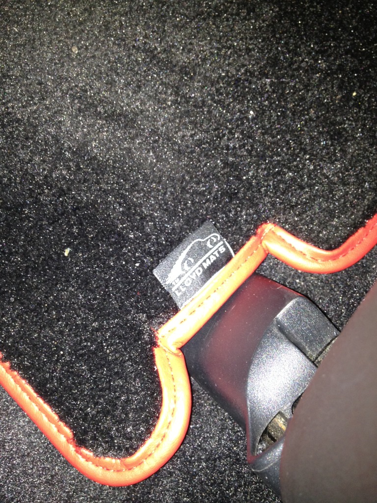

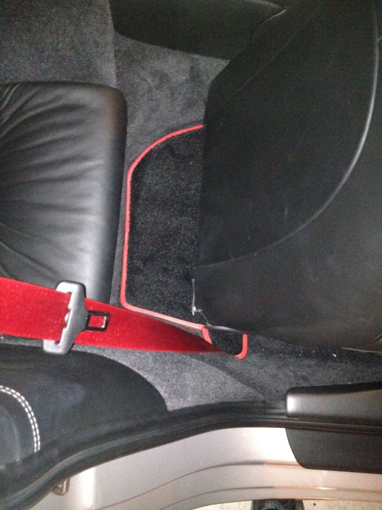

Needed to replace passenger side tail light housing because of crack, so I ordered custom Lloyd mats along with them off of Suncoast Porsche Parts (very quick shipping BTW). Very nice quality, I went with the red turbo font and red piping to match the seat belts. I like the way they are held down with the clip too. My last aftermarket mats weren't secured down and my driver side one folder, got caught under the pedals and I almost killed myself. Anyways, very nice overall! Even smelled clean too out of the box lol. Any questions about installation, please ask! Pics below

Very nice. They do look a bit darker than the cars carpet.

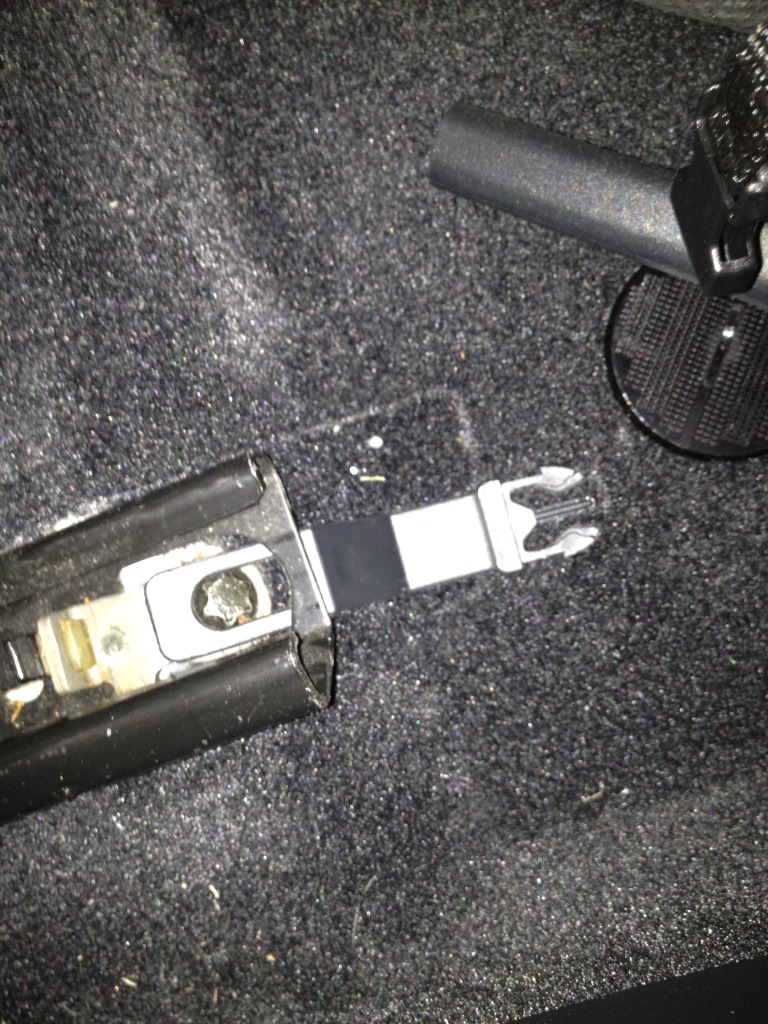

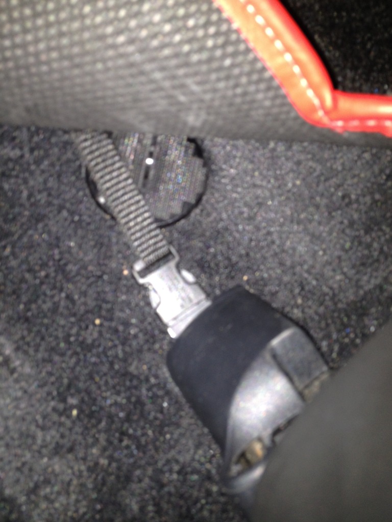

Originally Posted by Porschejeff
I ordered some also a month or so ago. I never clipped mine down as IWasn't sure how to do that. They don't seem to move around. But,just curious how did you clip those down?
On the seat, there is a safety bracket on either side. On top of them are little clips that hold them in place. Pull those clips up and then slide the safety bracket off. Now, take one of the clips that came with the mats (should be a total of 4) and slide the back of it so it holds on to the nut of the railing. Slide the safety bracket back on. The mat should now be able to be clipped up. You may need to fidget the clip a bit to make it work; it's definitely not a perfect fit. Then repeat 3 more times. Let me know if you need pictures of the process.
JAYANDRETT would you mind posting some pics here on those safety brackets, I would appreciate it.

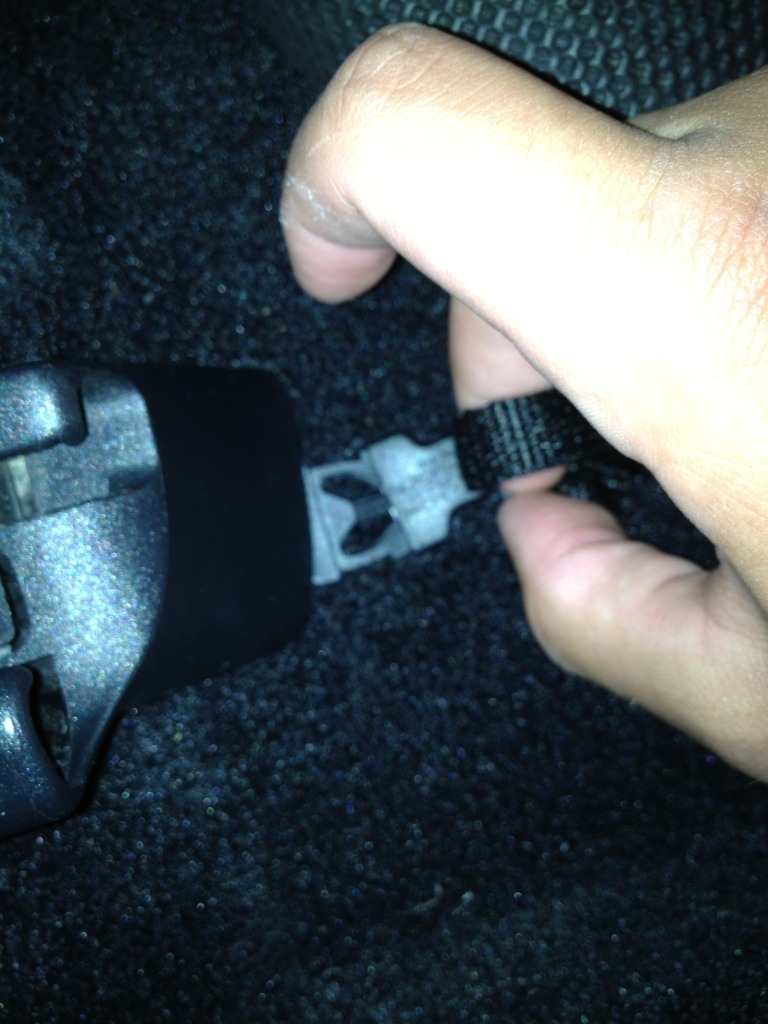

Here are the instructions for an easy install:

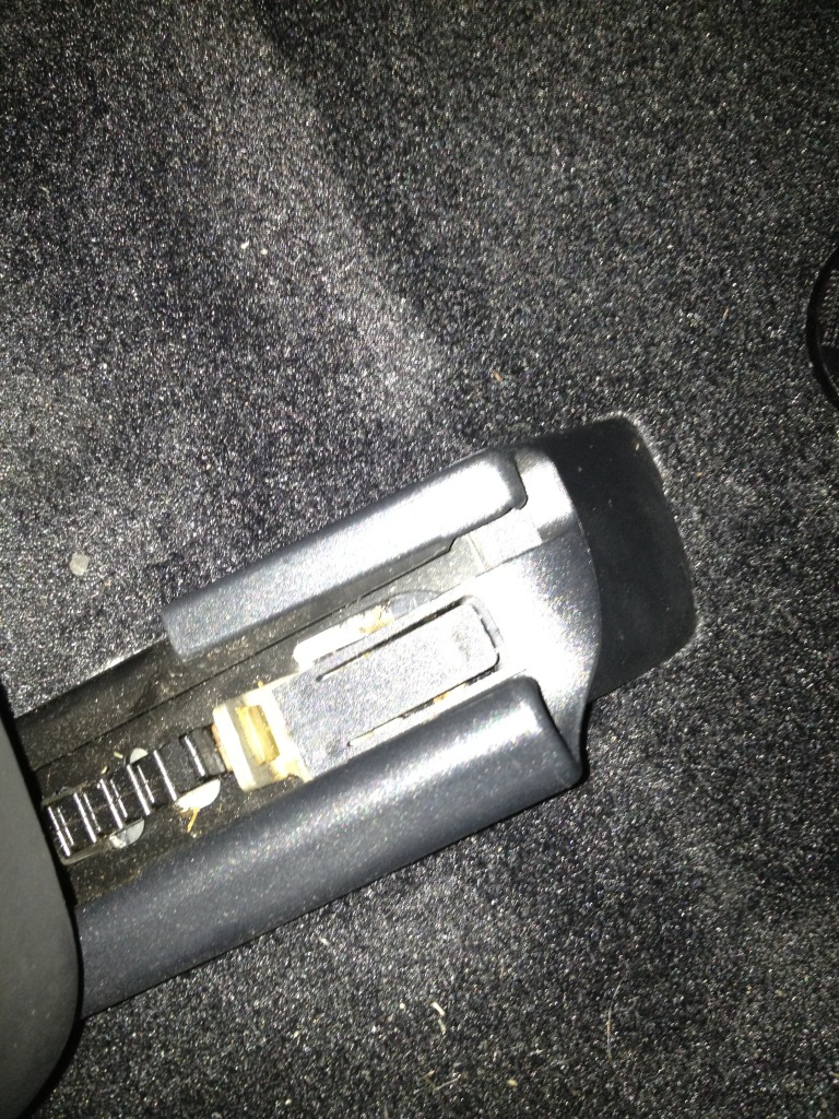

Here's what the railing with the safety cover looks like:
In order to remove this safety cover, get your nail under that long black tab and lift it like half an inch. The cover should then easily slide off when you pull it towards the front of the car:

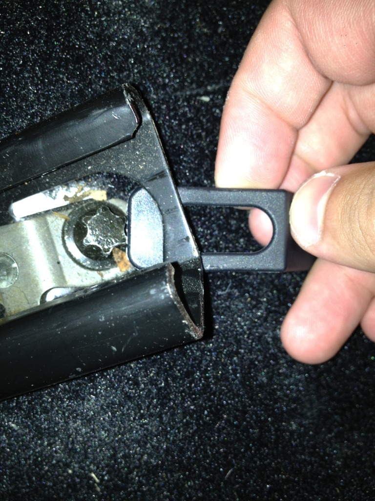

Now, take out those clips that the mats should have came with. Take one and slide the back of it so that it goes under the railing and around the bolt:

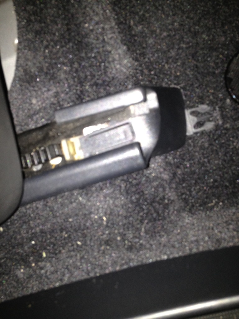

When it's around the bolt, pull the tab as far forward towards the nose of the car. It should look like this:

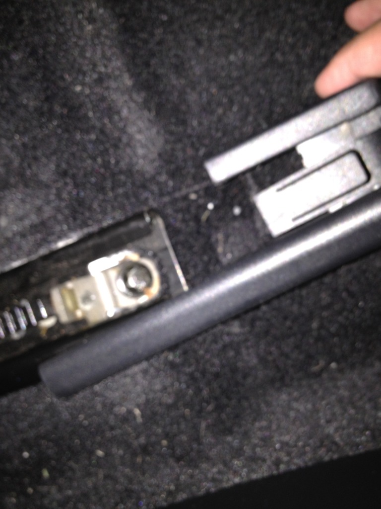

Slide the safety cover on to the railing. Make sure it properly lines up with the tracks.
You will here a click if the safety cover is slid into its proper resting position. If it doesn't click, pull the tab towards the nose of the car and slide the bracket towards the rear simultaneously. Just keep working at it until it clicks; it's not a perfect fit:
Now you can go ahead and clip in the underside of the mat. Hope this helped! Sorry for crappy pics btw, can't use a phone camera for crap
