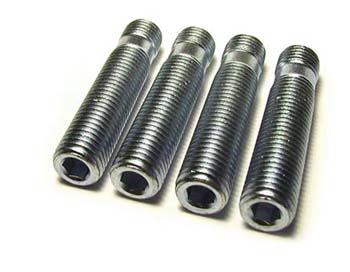

You my man are out of luck. You can put longer studs on but they will look silly. I am not a fan of spacers but some times they are needed. There are studs that have a allen in the end that you can remove the stud and then screw in the guide.
Old Jul 26, 2012 | 09:42 PM
Tim941NYC's Avatar
Joined: Jul 2010
Posts: 3,319
From: Long island NY
Rep Power: 381
Tim941NYC Is a GOD !Tim941NYC Is a GOD !Tim941NYC Is a GOD !Tim941NYC Is a GOD !Tim941NYC Is a GOD !Tim941NYC Is a GOD !Tim941NYC Is a GOD !Tim941NYC Is a GOD !Tim941NYC Is a GOD !Tim941NYC Is a GOD !Tim941NYC Is a GOD !
Like these:
Thanks, Tim. I think I may be hosed and have to buy some different spacers. The wheel is back on the car now, but from what I remember, the studs coming out were offset from the studs on the actual hub.
Let me take it to my indy for my next oil check and have him look at it and figure out a solution. I don't want to have to flat bed it if I'm out and about and get a flat. I like to be somewhat self-sufficient.
In this case, with my tire sort of having a disintegrated inside tread, I don't think that Fix-A-Flat would have done much good at all.
