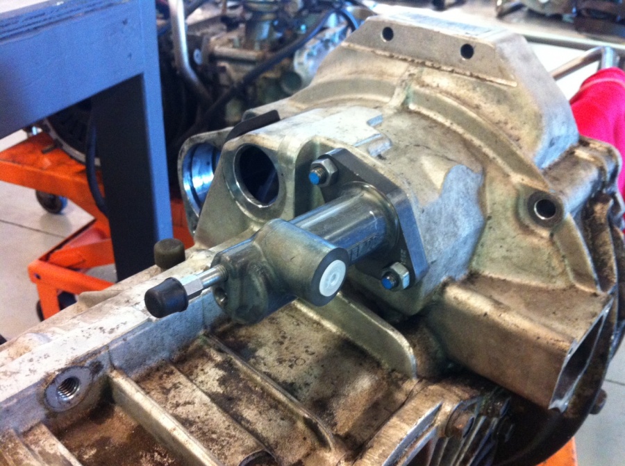

Anyone know where I can get the custom bracket for the GT2 Clutch Conversion Kit? I just need the bracket have all other parts.

If your car is in pieces you might think about just tapping the gearbox just like on the GT2 and not have to mess with the bracket. I just had mine done and the cost of tapping the gearbox was offset by not having to mess with the bracket or having to make a custom length slave rod to get a good engagement point. It was basically a wash. I think Mikelly posted on Rennlist that he had some slippage issues with using the adapter bracket and both he and Kevin at UMW recommend against it if I'm not mistaken. Just relaying what I have read so take it with a grain of salt. Either way, good luck with the project...
