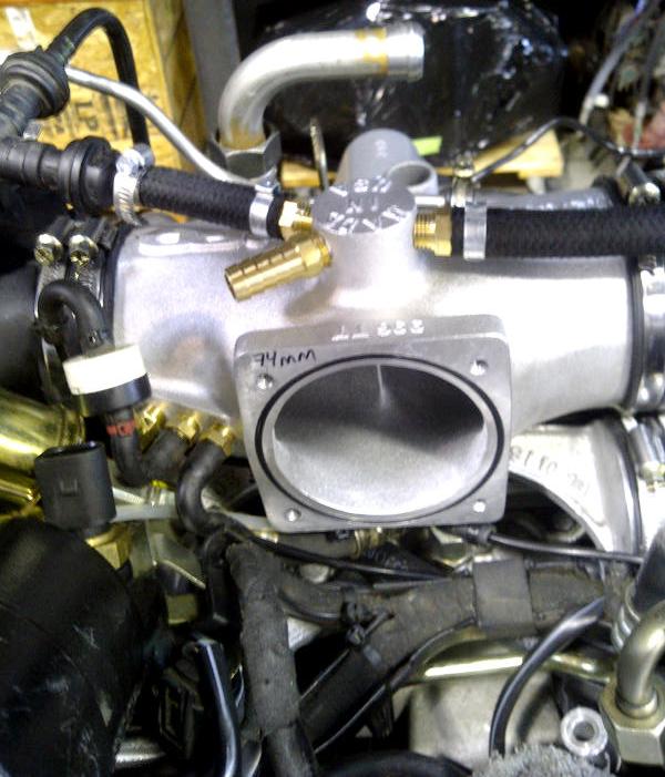

If you ever experience any issues related to any IPD products we are always here to answer any questions and help resolve any and all issues related to our products. 99% of all problems related to IPD Plenums are typically the result of an error during the installation process. This holds especially true with the 996 Turbo applications. The 996 Turbo Plenums are without question the most difficult of all Plenums to install and should only be performed by a qualified Porsche tech who is very familiar with 996 Turbos.
If an IPD Plenum for any Porsche application is installed correctly there should be absolutely ZERO running issues, ZERO CEL’s and deliver GREAT performance gains. That being said, IPD Plenums (as well as any other after-market performance mods for that matter) should ONLY be installed on a vehicle in good running condition that has been properly serviced and maintained. You should NEVER install performance parts on a car that’s experiencing any kind of running issues or is in need of service.
Bottom line, you are experiencing a vacuum leak. The most likely source of the vacuum leak is below the Plenum and throttle body where 4 vacuum lines are joined by a 4-way rubber vacuum line connector. It is VERY easy for one or more of these lines to become disconnected during the installation process, especially if the lines have any oil residue. We even recommend zip tying the rubber connector to the plastic vacuum lines to ensure a secure hold and prevent accidental disconnecting of the lines.
The other possibility is that the rubber boots that connect the Plenum to the intake manifold are not properly seated and/or properly clamped. It is critical that the manifold boots are correctly positioned with the hose clamps evenly aligned in the proper position to preventing “walking” when tightening the clamps. You need a small mirror to see the back side of the clamps to confirm that the clamps are in fact properly aligned.
We haven’t sold 20, 50 or even a few hundred of these, we’ve sold well over a thousand and when they’re installed correctly on a properly serviced Turbo they will deliver 35+ HP and Torque at the wheels while producing quicker boost response and a stronger pull throughout the entire power band on both bone stock and highly modded Turbos.
If anyone has any other questions, concerns or are experiencing any problems related to the IPD Plenums please drop us an e-mail or give us a call. We have been doing this for a long time and I swear, we actually know what we’re doing, really! We stand behind our entire product line and pride ourselves on having the best customer service and best after-market Porsche performance parts available, period.

Sorry to hear about the issues your having. Just to share my experience, I myself have a fully built 996tt and actually purchased two plenums. I used a 996tt plenum and then i ended upgrading to a the 997tt manifols which required me to run the 997tt model. Never had any issues. I personally experience is a much better spool resonse which is huge when running bigger turbos. I'm sure you'll get your car running right but it does sound like a vac leak. Good luck!
Make sure Greg gets you your free ipd sticker for an extra 15whp lol. jk

Do you think the larger TB could have helped that also?
