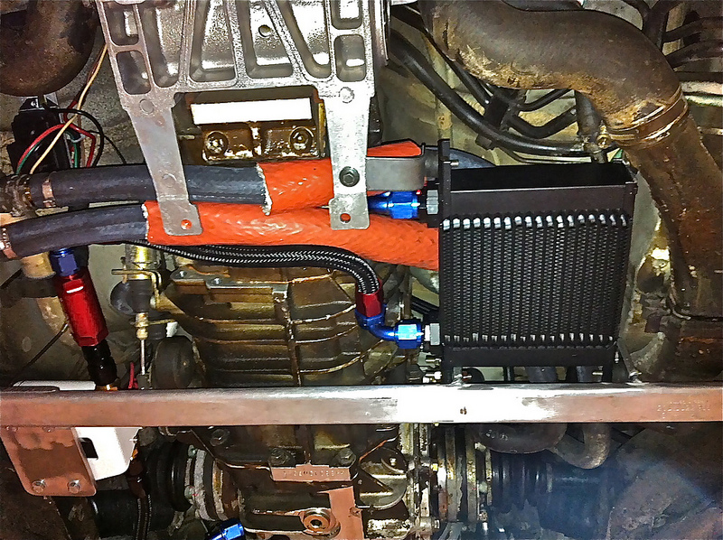

Since a number of you have PM'd me about the gearbox cooling system I have decided it would be easiest to do a quick write up on it. Basically, my decision to do a gearbox cooler was a result of tracking my Rturbo and a number of conversations I had with the builders of these gearboxes like Brian Copans and Gbox. Matt Monson of Guard Transmission who supplied his Guard GT Club LSD for my gearbox also highly recommended a cooler if tracking the car. Since I knew an LSD would raise the temps of the gearbox, especially when running the car hard at the track, for longevity purposes I decided that a cooler was a must. I track my car about 15 days per year.
After doing some research, I realized there were two ways of approaching this project since the gearbox and engine were removed on my car while my coolant pipes were getting welded and while the gearbox case was drilled and tapped for the GT2 slave conversion. One way to do this was to have the gearbox shipped to Gbox or Copans to have it machined and converted to the GT2/3 cooler components utilizing an internal spray bar and an external liquid to liquid cooler that uses the engine coolant to maintain the temperature of the gearbox. This option however would have been quite expensive with many parts required to be ordered from Germany (with several weeks lead time) and price wise at an estimated $6-7K+ and it just did not make sense. The other option was to do it the cheap way and just pull off the oil from the drain hole, run it through a pump and an external air to liquid cooler and return the cooled oil through the gearbox fill hole. This option would have been fairly cheap at an estimated $1-1.5K but I did not like the AN fitting hanging below the gearbox and exposed to potential damage from road debris. As a result, upon consultation with my tech at 3zero3 Motorsports, we decided to come up with a system that falls price wise between the two cooler options but actually offers much more in many aspects.
The one thing that I wanted with my application was to retain the factory drain and fill holes on the gearbox. I did not want to have to draw and return the fluid through those locations so that I would not have to disconnect any AN fittings when doing frequent gearbox oil changes as I normally do when tracking my car. As a result, we decided to drill and tap the gearbox case on the side under the passenger side axle and draw the gearbox oil from that location. This location is very close to the LSD and thus has the hottest oil due to the friction of the clutches. From there, the oil is drawn via a MOCAL oil pump (located on the passenger side of the gearbox ahead of the drive axle) and driven though an oil filter into an external air to liquid cooler located on the driver's side of the gearbox in a location similar to where the factory GT2/3 cooler resides. After the oil passes through the oil cooler it is returned through the top of the gearbox which was drilled and tapped for that purpose. A MOCAL pump, even though it is expensive at around $400, was chosen due to the fact that it is a gear pump as opposed to a diaphragm pump like a Tilton. The advantage of a gear pump is the fact that it is much quieter and more efficient than a pump like a Tilton. When the MOCAL pump is running with the car shut off, you can barely hear it, just a faint whirr. With the car engine running, it is inaudible. The Tilton diaphragm pump by comparison is very noisy due to its diaphram design. All of the hardware like the pump and the cooler is mounted via rubber lord mounts to dampen any noise and vibration.
In addition to the cooler, I also wanted the system to be "hands off", reliable, easy to service, and to provide me some feedback in the car as to the gear oil temperature. To make the system "hands off", it was decided that we would use an adjustable OEM quality automotive thermostat switch to activate the oil pump at a preset temperature which I have set at 200F. I chose 200F since this is close to the coolant temperature that the GT2/3 uses to cool the gear oil with its respective liquid to liquid cooler. In order to use a thermostat switch we needed to insert a temperature pick up probe into the gearbox and did so by drilling and tapping a location in the side of the case near the same spot under the passenger axle where the oil pick up is tapped. Once again, this is near the LSD where the hottest oil is. As a result, when the thermostat senses a temperature of 200F it activates the pump which in turn starts to circulate the gear oil through the cooler. The pump will run continuously until the oil temperature drops to around 180F at which point it stops. There is also a small LED installed (in the lower portion of the center dash below the climate control) which lights up green when the pump is energized and running. In addition, there is also a manual override switch next to the LED that I can use to turn on the pump independent of the thermostat.

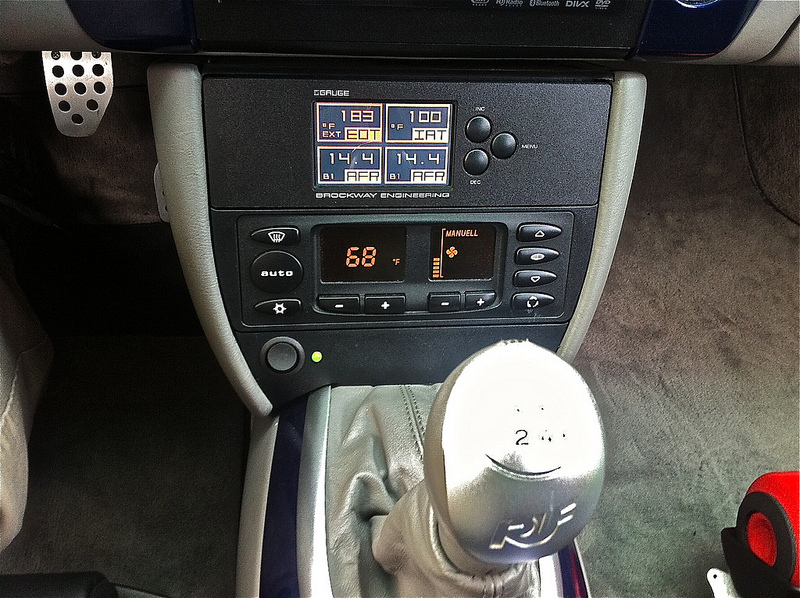

The last part of the gearbox cooling system I wanted to employ was some type of an indicator in the car that would give me a temperature readout of the gearbox oil. I looked at many options but one of my requirements was that the install must be very OEM looking. I just did not want to have some gauge stuck in the dash that would look out of place in the car. After much research I decided to employ the Brockway Dgauge with its 996 specific console mount as it is a direct drop in to the 996 console and looks perfectly OEM. The Dgauge has an option to plug in an external sensor for numerous items with oil temperature being one of them. You can purchase the various sensors directly from Brockway and they are OEM automotive quality parts. The side benefit of the Dgauge is the fact that you get a display of countless user selectable data that the unit pulls up through the OBDII port. You have a choice to select up to 4 parameters on the Dgauge display and I chose to have the gearbox oil temp in the upper left, IAT in the upper right, and AFRs for both banks of the motor in the lower left and right. Display colors are also user selectable. The Dgauge is a self contained unit that is powered through the OBDII port and required no wiring besides plugging in the flat connector to the OBD. The final step was to insert one more temperature probe in the gear box and again this was done in a similar fashion as with the thermostat probe by drilling and tapping the case in the location under the passenger axle. If you decide to go with a Dgauge on the 996tt, ask Eric at Brockway to download software V1.24 to ensure the unit Auto shutdown and startup sequence functions correctly in our cars. I sent mine in to Eric at Brockway and we came up with this update for the 996tt since our ECU functions a little differently from other cars.

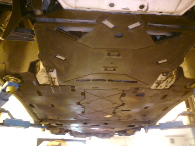

**** The transmission belly pan with the NACA duct that covers everything of obviously omitted from the pictures for clarity purposes****

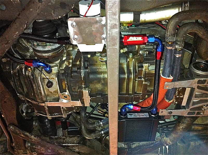

Looking at the transmission from the passenger side of the car. Note the MOCAL pump mounted in the center at the top of the picture. The oil filter is the red "tube" visible just to the right of the pump
Looking at the transmission from the front of the car. Note the thermostat mounted in the upper left of the picture next to the transmission mount

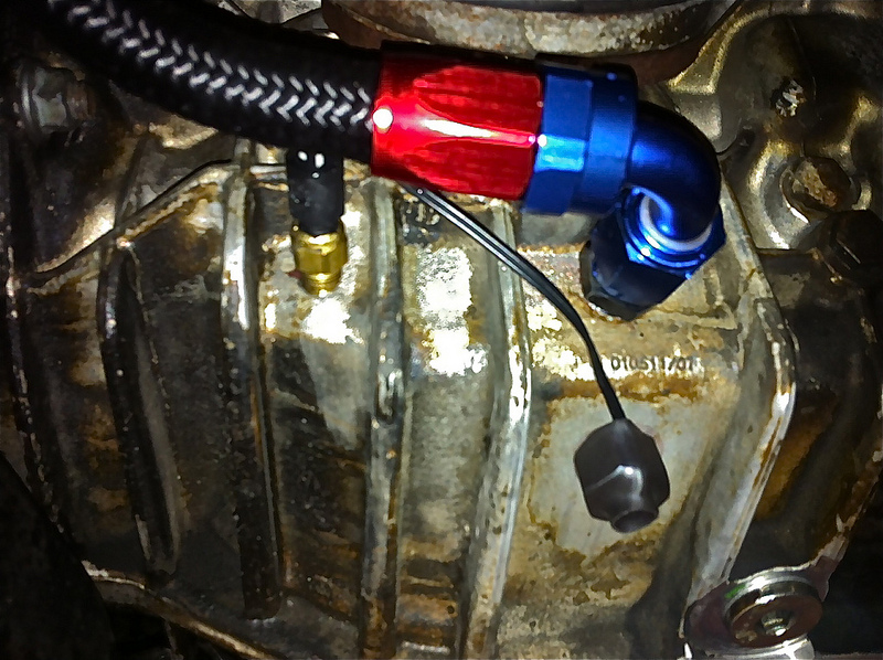

AN fitting for oil pick up and the temp probes for the thermostat and Dgauge

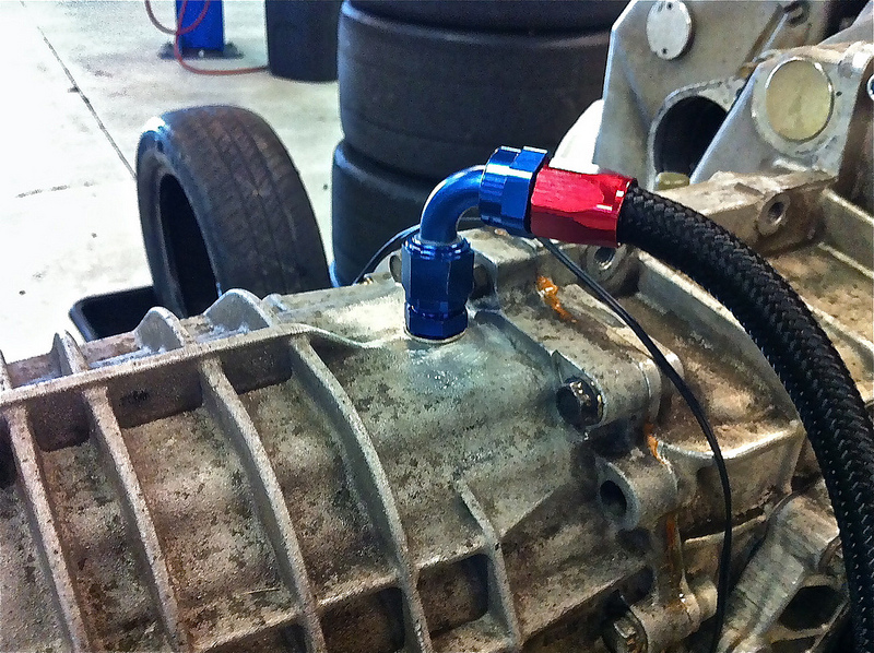

Oil return via AN fitting at the top of the gear box
Dgauge installed in the console. Note the manual override switch and LED in the batwings

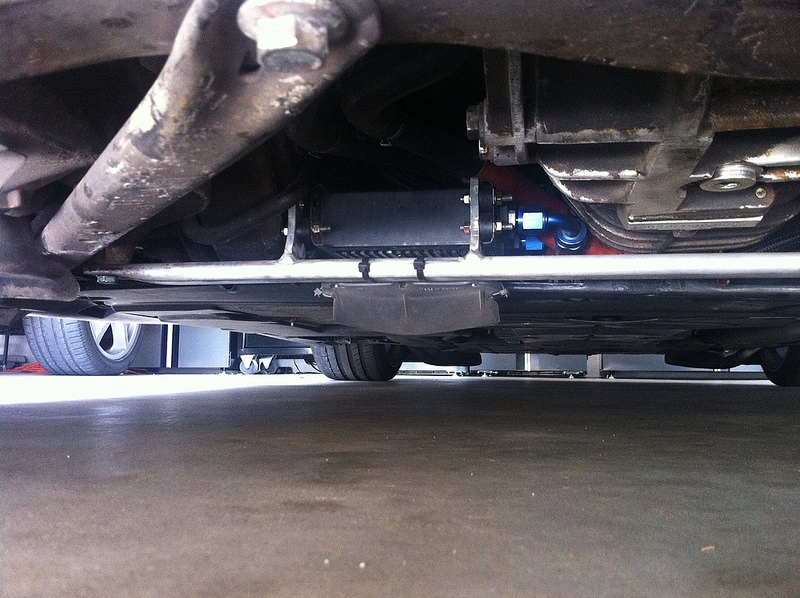

Rubber air scoop that is attached to the aft end of the belly pan behind the NACA duct to direct air to the air to liquid cooler. The rubber air scoop is a Porsche part utilized on the Boxter.

Setup looks great, with one exception (or at least question, on my part).
How does that air-to-air cooler get any meaningful airflow routed through it? It appears to be mounted up on its side?
Overall, regardless, great job - should keep those temps in check and aid in the longevity of the trans.
A very clean install without sacrificing quality. I particularly like the gearbox oil temperature readout. Nicely done !

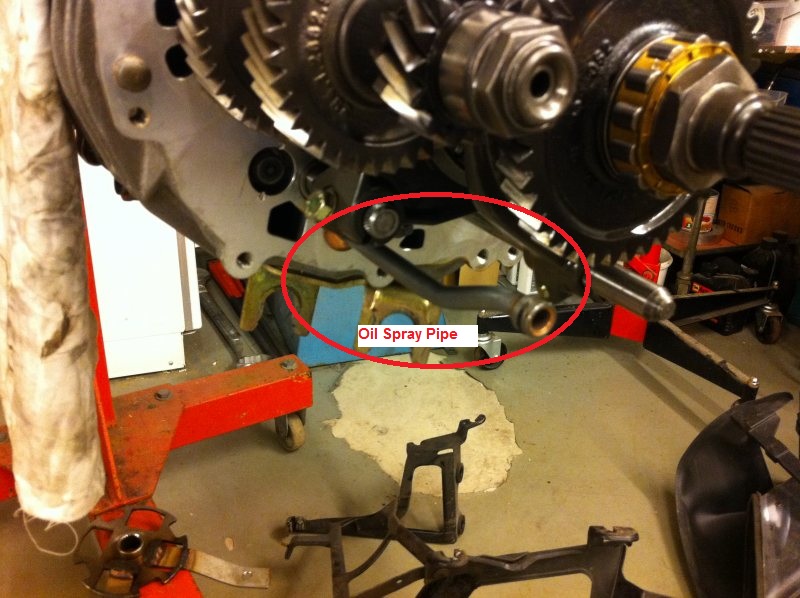

So I went thru the exact thinking as you, but executed it a bit different. :-)
I wanted the setup to be as much alike a CUP car as possible because I know for a fact that their temperature stays bellow 125C on slicks regardless of outside temp with there Liquid-liquid solution.
I also wanted to spray both all gears and the diff in the rear end.

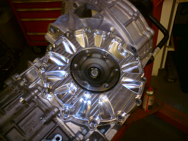

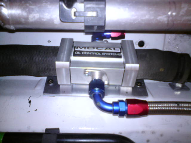

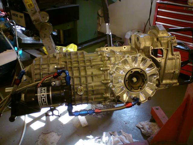

But just as you I couldnt go with a OEM cooler kit because it felt way to expensive! So just as you I have a Mocal pump but on the driver side taking oil out thru my heavy duty diff cover.
Then we machined in an OEM spray pipe which wasnt that expensive and a connection thru the housing in the front of the gearbox. just to get all gearsets sprayed with oil for coolant and lubrication.
Finally I used a Mocal Liquid to liquid oilcooler as well installed just like OEM.
Two different ways of doing it. The to things I prefer with my solution is the spray pipe for all gears and its liquid-liquid design just because I wasnt 100% sure about the air circulation if I had choosen the aircooler, espacially since I have a 997 flatfloor.
Here are some pics of my installation!
Your cooler looks great. Two ways to skin a cat I guess. I have yet to see oil temps over 220F (105C) with my setup and usually the temps stabilize around 205F (96C). How hot does your oil get on the track? Do you have a temp readout with your set up? I would imagine I operate my car at much hotter ambient temperatures than what you see in Sweden. Our ambient track temps this summer hovered around 130F (54C) and last week when i did my testing were around 37C.
Exactly, two ways to solve the problem! :-)
Actually to be honest I runned the car for 2 years without a temp gauge. But as it feels a bit stupid to have installed all of this without knowing the results I installed a gauge actually this week. So hopefully I can get back to this thread after the weekend with an answer! :-)
In the summertime we get temperatures up to around 30C but not much above that! So considering your outside temperatures were you live your solution seem to work great!

Yeah, let me know what you find out Pete. I looked at both the liquid to liquid and the air to liquid solution and decided that the air to liquid cooler would be more thermally efficient at my ambient temperatures since I am using a 80F-120F medium (air) to cool the oil as opposed to a 190F medium (engine coolant) to cool the oil. Keep me posted. Thx! Also, I assume you are running an LSD?
