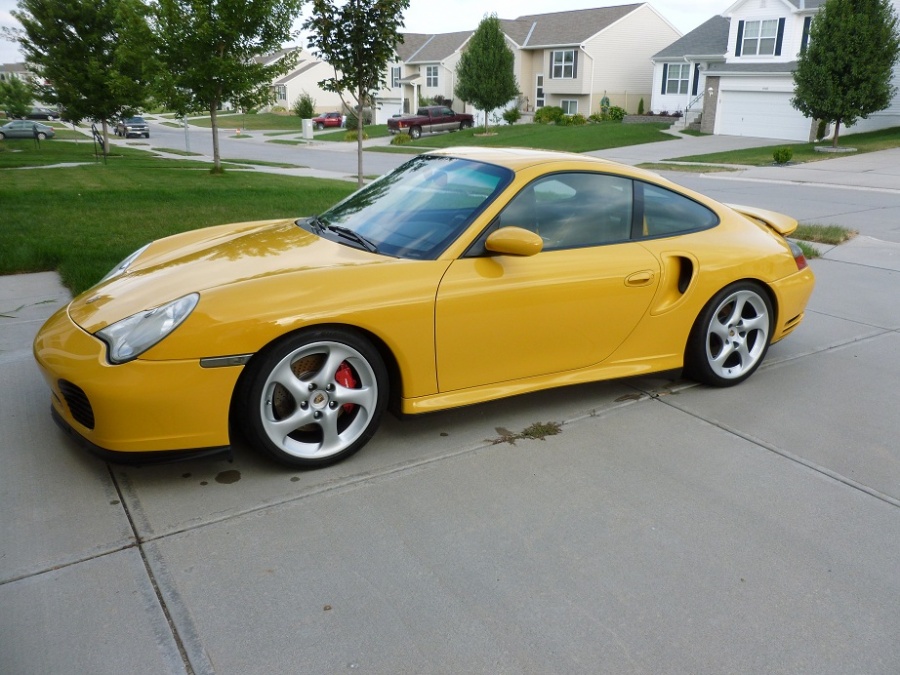

no issues here... they look equally good on the OEM wheels as well! regarding tire wear for street duty i've just been running hankook ventus evo's and put over 5k on them and the rears don't show any signs of going kaput or anywhere near it. yea they aren't as sticky as the high priced stuff but for 90% of my street driving around here I can't notice a difference in performance and they wear awesome.
