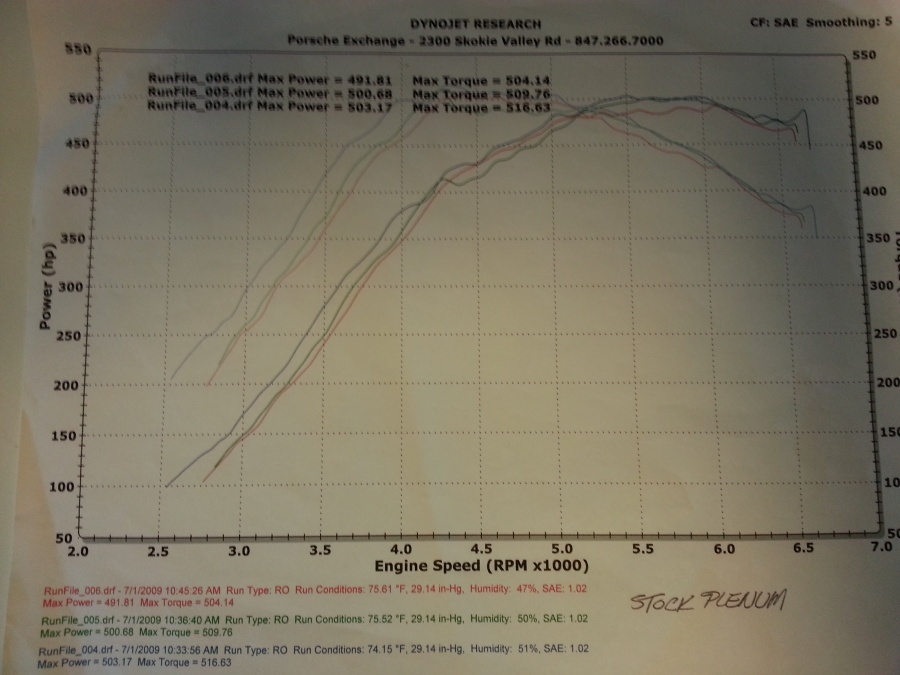

Earlier discussions on the forum when K24 was past being interesting and comparisons to billet turbos and K24/18Gs were hot topics and tuners went into great research, they were benched around the facts that a stock k24 has a 30lb compressor and that "...the 996tt engine produces about 9.25hp/lb/min of air, so a stock k24 with 30lbs/min of air times two of course can make about 30x2x9.25=555hp at the crank before it runs out of air and maintains some sort of efficiency."
From there a lot of effort has gone into discussions of solutions to reduce the pressure losses through the entire tubing in addition to just a flash and exhaust, to improve those numbers.
GIAC's own dynochart is here for K24 with a common list of mods below. Now pls notice this dyno might be calibrated low vs OEM/REAL hp and it's on 91 Oct (somebody chime in how big is the 91 vs 93 difference?), but overall it's just a reference of difference to the above graphs and mainly it's used by the tuner for their own advertising.
https://www.6speedonline.com/forums/...are-996tt.html
But what I find more useful is that GIAC announces that their flash generates a 65hp gain over GT2/X50 (with modifying wastegates and when talking to them it requires a free flowing exhaust to get that gain). That'd be roughly 475hp crank + 65 = 540 crank hp.
As a sidenote GMG announces a 60-70hp gain over GT2/X50 with their flash.
These are both big players and I don't know whom to believe anymore... I also saw first hand what my top notch tuner was able to gain from my K24 setup w racegas referenced earlier.
Since it's Friday and time to go enjoy the weekend I will officially join the OP and ask the same question he posted and let others duke it out bc ppl with long history here and a lot of +rep has posted graphs testifying that their gains to past and beyond 500whp are true, but the vendor supplying the tune says smth else. I guess depending on who you ask, the answer will always be different.

I saw that GIAC mentioned they had a part on their Dyno sheet ,that I tested on my car back to back that day..Lets just say I put that stock part back on in which those were my best numbers and a better mid/upper power band..I had the stock TB though..
Andrew from GIAC has other guys dyno sheets that did right around the same power and even a little more then me..
When I first got my K24/18gs,EPL tune with his 72 injectors and went to AMS on their rear wheel dyno jet , I was sick because I only made 525 HP and 541 TQ..I then tryed the EVO inlet pipes after that because everyone said that was the reason..Well hate to say it they didnt do anything at that level,,Believe or Not..
But when I changed to the Milltek 100 cell exhaust,,I piked up 30 HP and 50 TQ but it was a gain all thru the powerband and the boost on my dash gage went up also,,,Its all in the combo of parts working together..

What you really need to look at on the dyno charts is what correction factor is being used. You can play with the altitude in there and do crazy stuff with the numbers, even if it is SAE corrected. If the chart is SAE corrected, then you are looking at real numbers as long as the dyno operator is legit.
The dyno chart posted above is STD correction factor on a dynojet, that is not real HP figures (usually about 2.6% higher than SAE). On a DynoDynamics make sure the readout is not in Shootout mode, this raises the numbers to about the same level as Dynojet STD. Mustang dynos can also use any correction factor.
Another thing to watch is the smoothing correction. It does just like it states and smooths out the chart to make it look nicer. 0= raw data and 5 is usually the highest. Running low correction will usually give you a false peak and most of the time you will see 3-5 being used.
