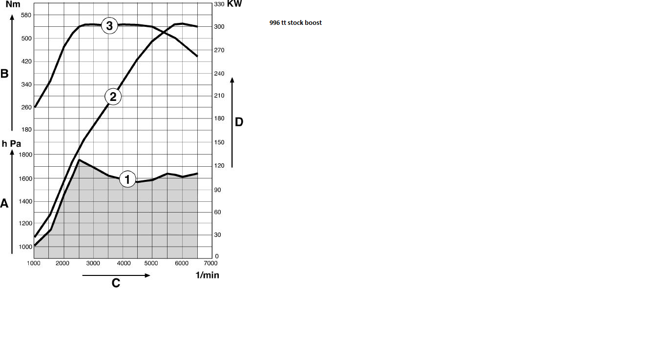

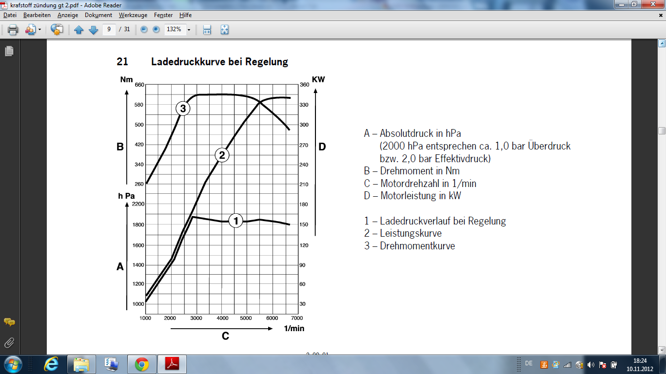

996tt boost line and gt2 boost line in attachment....
Name:	stock boost 996 tt.png
ID:	191590   Click image for larger version
Name:	GT2 Ladedruck.png
are those stock k16 vs k24's? or an x50 ( k24 ) vs a gt2 ( k24 )? the latter of which is "essentially" the same map. no?
