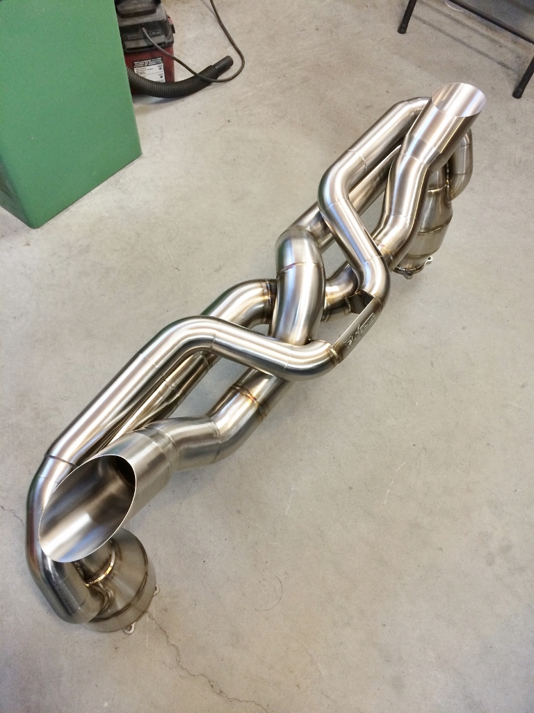

What does this sound like....
The "love hump"

^ this looks absolutely insane.. but would it not just sound like a cat bypass, or possibly an aftermarket exhaust with an exhaust leak?

Not sure why it would sound like a leak. Those tubes are capped, so all the sound exits at the tips....

Was that designed by a plumber? LOL..

Dual outlet post cat ? Where do the secondary tubes plumb back into if they are capped ?

Guys the extra pipes are capped at the end, it's not for more flow. It's a resonator, removes drone through a mathematical calculation of wave length canceling. Most of these type of pipes are quarter length resonators.
Often referred to as Helmholtz chambers but are technically not the same but used for the same purpose.

Starting to suspect this is true.

Well some do just not in the porsche market.
Apparently corsa has this theory incorporated in their mufflers and have for a while.
I think I'm going to do it in my x pipe I built. Won't be nearly as pretty.
