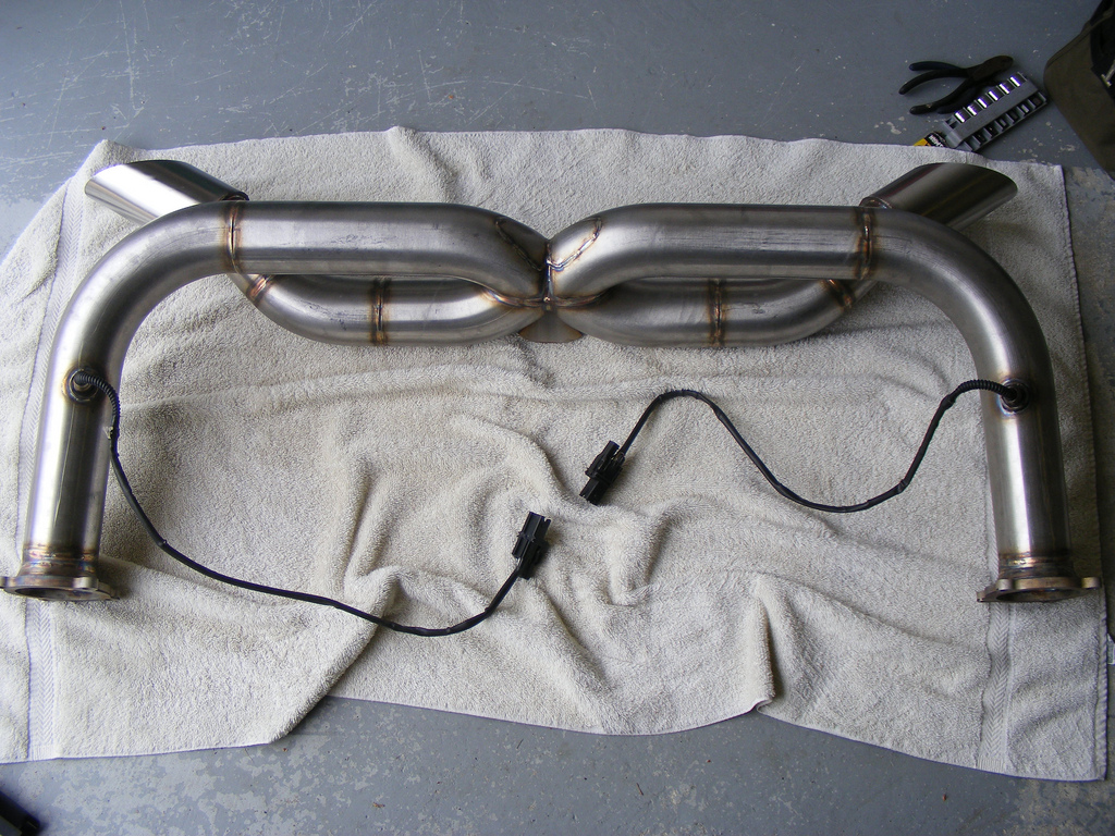

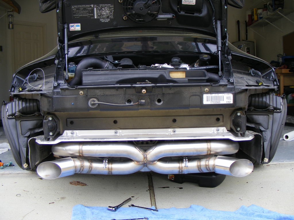

I was procrastinating making a separate exhaust review thread and some other goodies, but since this thread is back from the grave I'll just post here.
I've been running one of Chris's exhausts for a while now.
I can't comment on the "highly modified" exhaust Jkyll is running, but hopefully the pictures and a few words can help others who may come across this thread in the future.
As you can see, my exhaust is very basic straight through design. I had debated getting resonators at the time, but it was going to substantially increase the wait time and I was impatient so I didn't.
To anyone trying to decide between non-resonated/resonated exhaust for street use, do yourself a favor and get a resonated exhaust.
I had run open downpipe cars in the past and like to think of myself as macho kind of guy who doesn't care about decibel level, or what women who ride in the car think. If I could go back, I'd wait the 6 weeks for a resonated exhaust.
NOW, having said that. The car is very loud (understandably) giving it throttle between 2k-3k. After warming up though and cruising at any speed I find it 100% tolerable with no complaints. Ideally if I could magically make the exhaust 80% as loud as it is, I would, but overall it's not an issue. After all it is a straight through design.
The sounds of the turbos spinning on decel, or even when I blip the throttle a little are perfect and exactly what I was hoping for in that regard.
The exhaust is super light. I could easily maneuver it around with 1 hand, and feel like I could throw it 20 yards. I think it weighs around 10 lbs but don't quote me on that.
The craftsmanship and fit were very good. Chris was pleasant to deal with. If I have exhaust/welding needs in the future I will go back to him.
The install was easy, I did the exhaust and oil change in 3 hours by myself in my driveway without a jack or jack stands.
I can make some videos for anyone that may be interested, but like has already been said, those don't necessarily translate the sound as you'd hear it in person.
