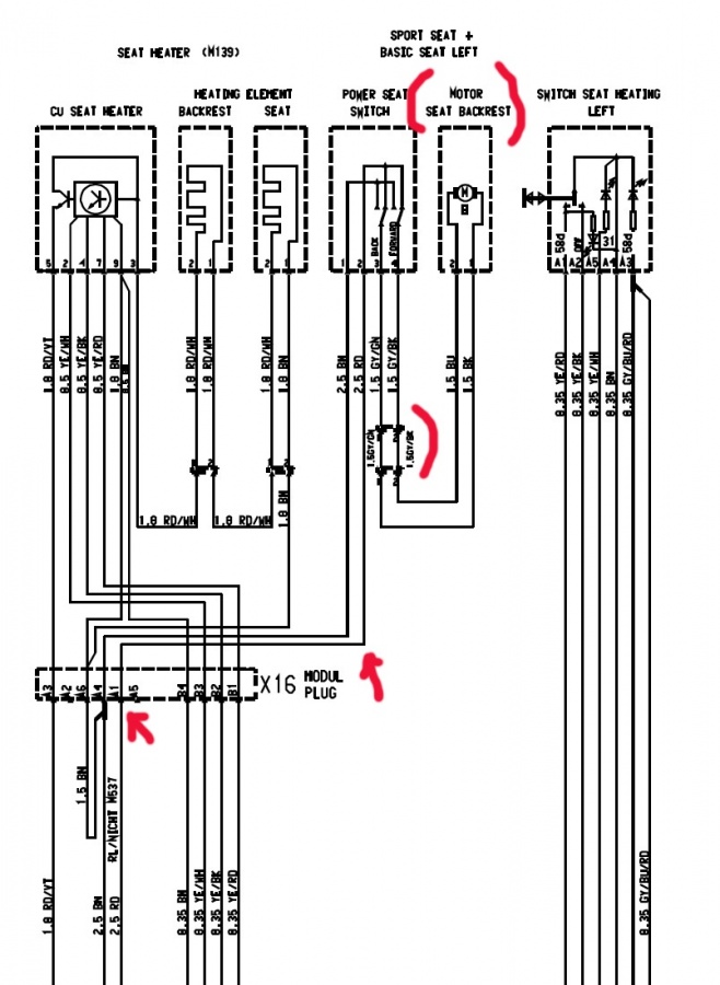

This is the diagnostic page for your code. Has mention by Slider it is straight forward troubleshooting. But some people mention in the past humidity on the floor even water. I hope it is not your case. May be a good clean up of your under seat plug with a good contact cleaner can be your solution. This is the wiring diagram for the 2002 model. We can see two plugs, one under the seat and one in the seat itself. Wire plug under the seat, connector A1 and A5 are the one supplying voltage to the seat power switch and after gray/black wire and gray/green wire supply voltage to the backrest motor....
