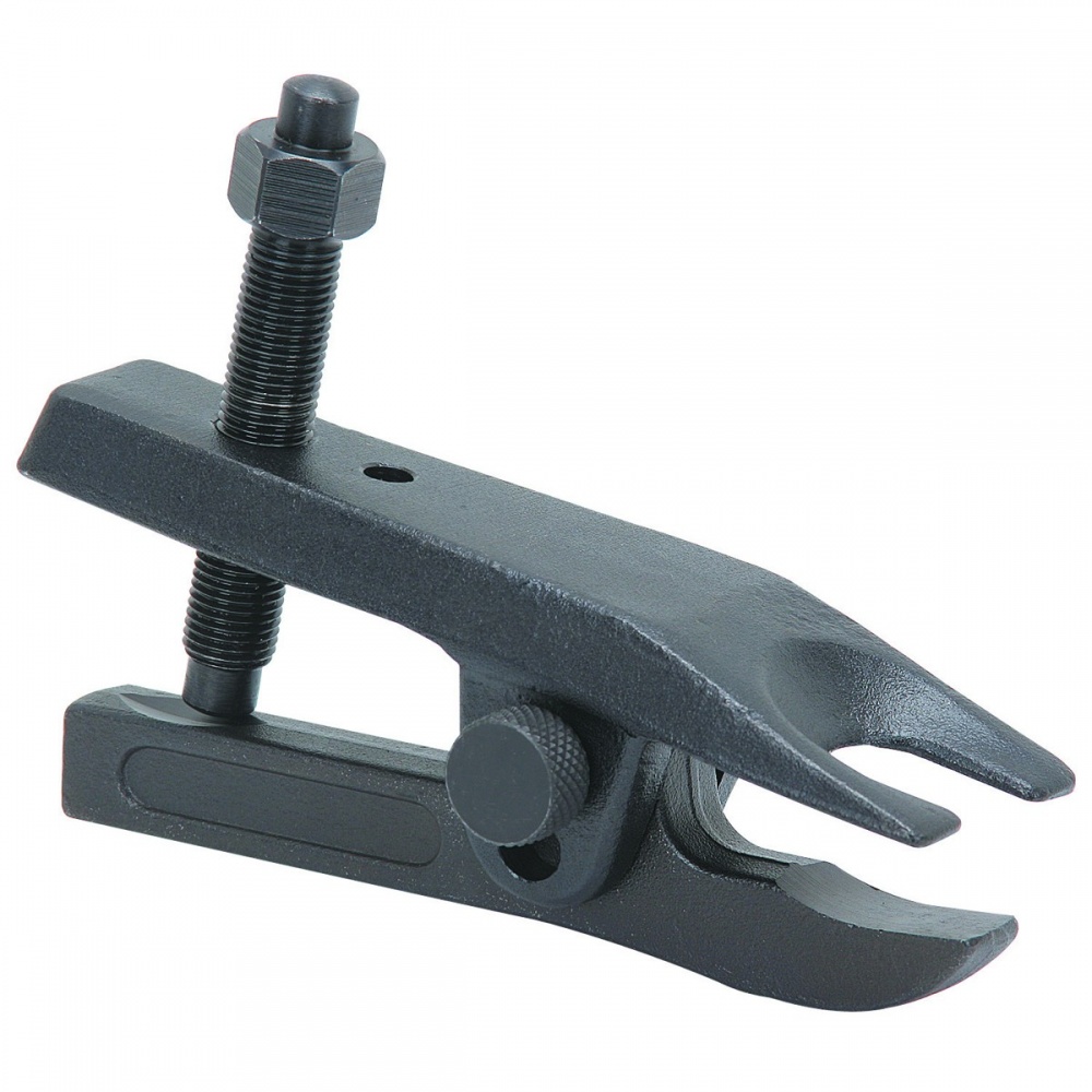

Make sure if you are separating the lower ball joint or tie rod end you use a tool like this rather than a pickle fork.

no need to if you try my way
It's definitely tight but doable that way. I used the blue tape on my fender lip as well. I'd recommend a couple layers.
