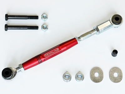

I know Max. I'm pretty close to their shop, and they've worked on it before. Are these the type of links you have?
http://www.rennline.com/Rear-Toe-Con...nfo/S70.10.41/
The link below is for the toe arms I use. They are excellent. No issues with wear whatsoever after being on the car for the last 15K miles with numerous track days over the last two years. Zero noise...
http://www.tarett.com/items/996-997-...lnk-detail.htm
