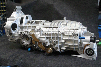

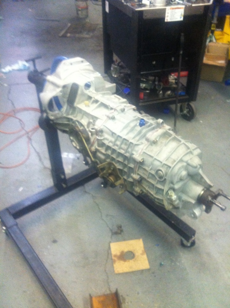

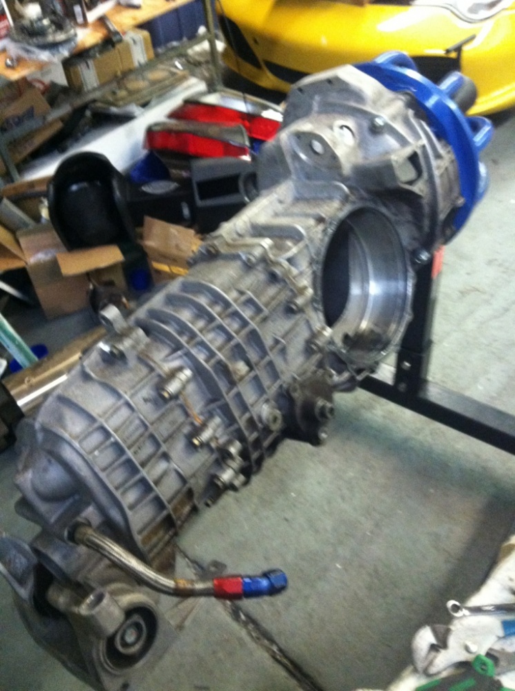

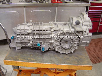

Wiki?? Really? SMH.. "Add a rear lsd and both rear wheels need to loose traction before the viscous sees speed differential and begins to transfer more power." You need to learn a few thing about diff's and how they work, transfer power how they get connected.. Also I think you should take one of these cars apart before you make any further comments. The transaxle in the 996/7 tt/4/4s uses a simple spline on the pinion shaft that is extended out of the trans case where a yoke slips over and is bolted down. that yoke is now connected to the front drive via a drive shaft. That yoke sees 50% power ALL the time, direct connection rear pinion to yoke. Its one part #8 in first pic. In fact the input side of your "magic" viscous coupler sees 50% of the power ALL the time. A lsd has no influence on how the viscous coupler works at all. A lsd simply needs the viscous coupler work less do to both rear wheels providing power to the ground. Do you know why the front tires and rear tires are not the same run out? Check Wiki...
Turbo trans, black yoke right on top of the trans mount.
GT2/3 no yoke in that area.
Credit to Roger at CMS for the pics off his site.
Or from my own phone:
Gt2.. yokeless
Turbo.. yoke
