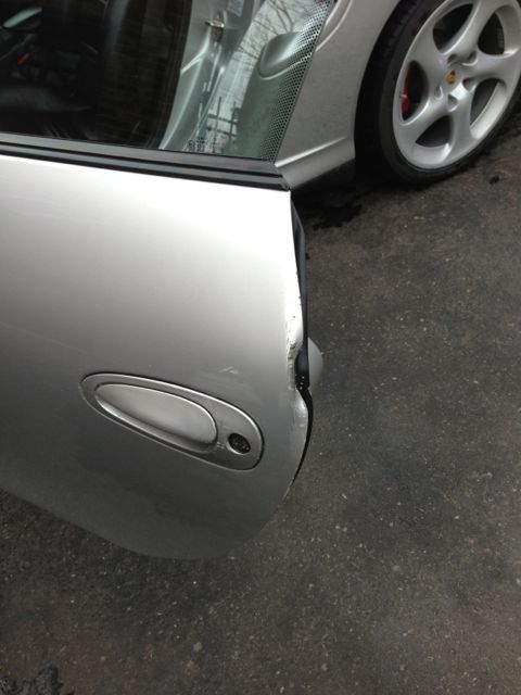

OP here. Thanks for all the responses. Really appreciate it. Went for a test drive today, but TBH, I didn't really do a good job. My observations as follows:
1) The car surprised me with how predictably it reacted when I pressed the accelerator pedal. Press down a bit and the car accelerates, but nothing crazy torquey and never felt out of control. Press it down faster or further down and the car just explodes, but still with a feeling of great control. My S4 was just touquey and while solid, didn't feel as "safe" when pressing down on the peddle. Just wondering if this descriptions seems accurate to you 996tt drivers. Almost feels like the first third of the accelerator I could use to drive the car with fuel economy in mind and the bottom 2/3 of the accelerator is to take off.
2) Car felt very tight. No squeaks or rattles.

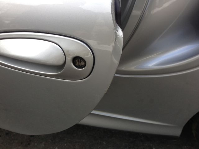

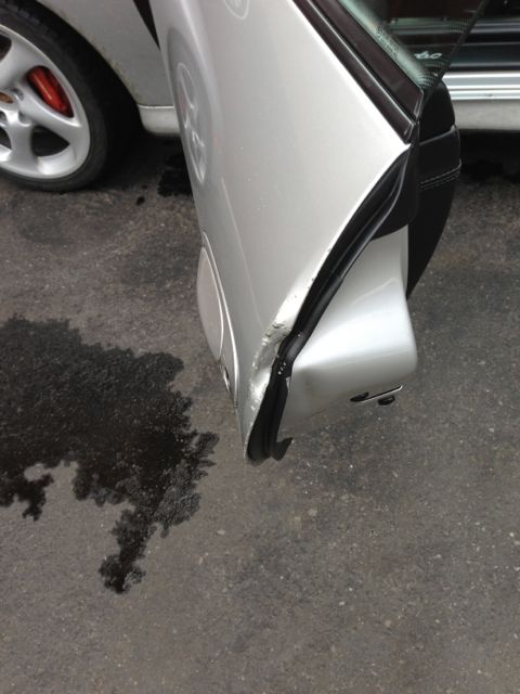

3) Interior was very clean. Overall condition of the car seemed immaculate except for a dent on the drivers side door that the owner claims occurred when backing up out of his garage with the door slightly open. Pics attached. Cost to repair at the Porsche dealer is $1400 + tx. I initially wasn't too concerned about this, but a friend pointed out that I should have checked the hinges and door frame for deformities which could cause undue wind noise at high speeds.
4) Seller seems like the rich, yuppie, old money type. President of a well known charitable foundation, seems honest. Doesn't really have a clue about Porsches (e.g. had no clue about the metzger engine or the history of the engine). Doesn't seem like a scammer. Still, sometimes these types are the worst types, so not taking anything for granted.
We're looking at a price in the mid 30s for this 2003tt with 60K miles on it.
My next steps are as follows:
1) Get some of your thoughts on the maintenance history of the car...full details below . Any opinions about that door dent and story? I'm wondering if it wasn't a theft attempt.
2) Going to shop for a PPI. Going to call a porsche dealership and a non-dealer porsche mechanic. I want to get the compression test and leak down test done as well.
3) I'll probably go back to the seller and see the car again and do a more thorough inspection of the door frame and the other suggestions from all of you especially King James.
