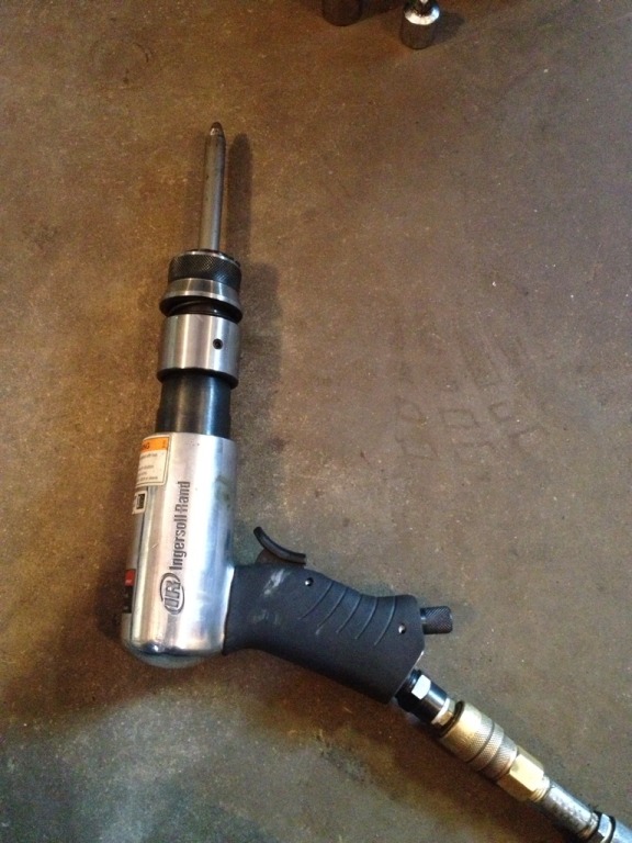

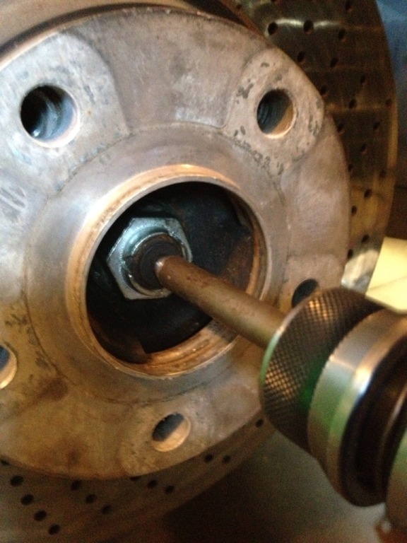

2. Back the axle nut to the edge of the axle so it protects the threads. Use an air hammer and chisel bit to knock the axle loose from the hub
The axle will free up - you can then remove the axle nut and remove the axle by hand.

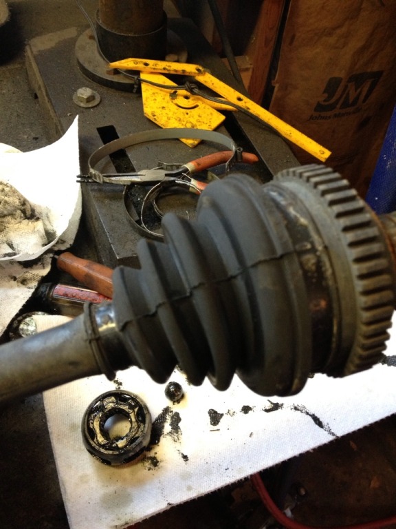

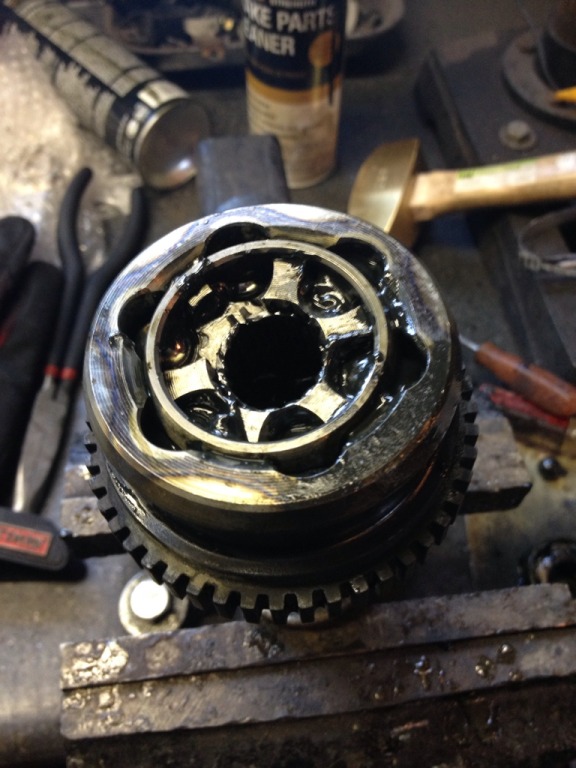

3. Put the axle in a suitable vice - Remove the dust boot clips

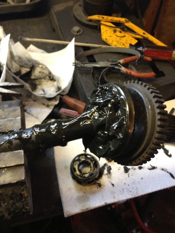

4. Use a dull utensil or flat headed screwdriver to break the seal loose of the CV boot. Slide it out of the way to reveal this terrible mess

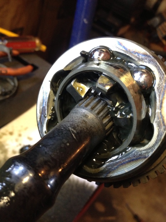

5. Clean it all off with a rag, and then hit it with a good amount of parts cleaner. Do this several times and continue to work/wobble the CV around so it works more grease out. The more you can get out now the less messy you'll get. Eventually you'll clean enough to reveal the C-clip that holds the CV onto the shaft as shown

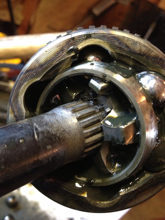

6. I used a small flat headed screwdriver to get the C-clip pried apart a little. I then wedged in a set of ground-down 90 degree needle nose pliars and pried them apart. This will take several attemps as it requires some finesse. I used a brass hammer to lightly tap the CV forward. You can see here the clip is off of the groove and CV has moved outwards a bit
7. Continue off, now you can discard or set-aside the shaft (Yes, thats 100% pure genuine hickory in the background)
8. Put the leftover CV portion in the vice

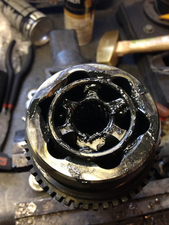

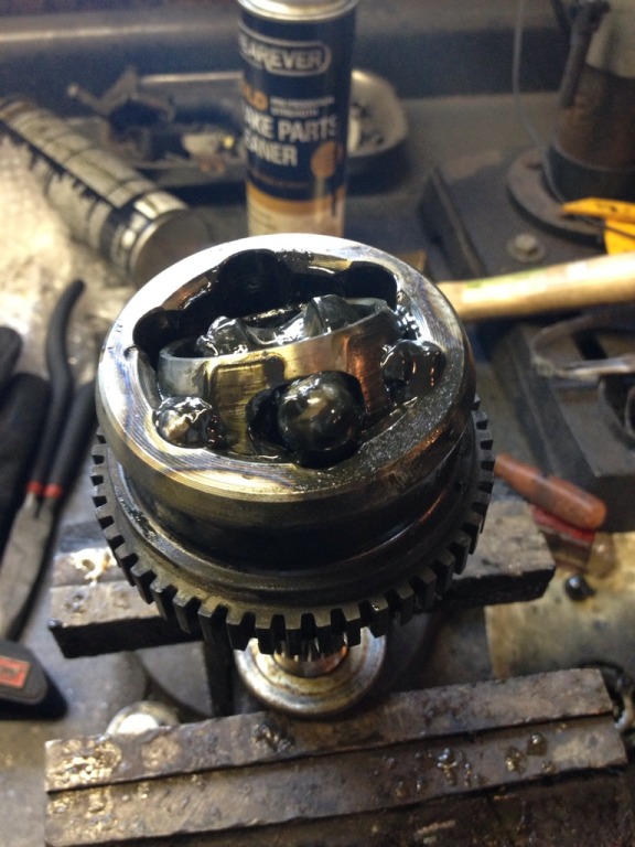

9. Using a small hammer you can move around the race to begin pulling out the bearings. One by one you can use a magnet to remove them.
10. Now you can remove the race. It appears like its stuck in there by some form of sorcery...position it as follows and it will pull straight upwards.
11. Now clean it all up and install in the car.
12. Feel good you didn't just pull a VGLNTE and beat the **** out of it with a hammer.

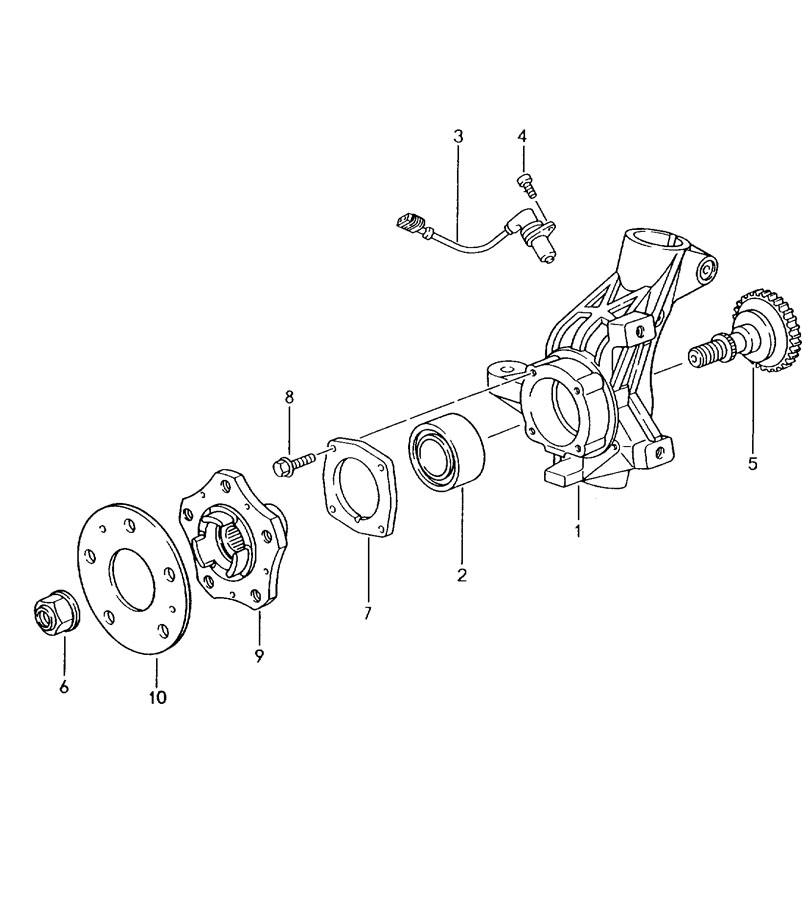

Hi,
I just don't understand why everybody is going to the trouble of destroying good axles.
You can replace the stub AKA "Tension bolt" with the 2WD part from the GT2 or 996.
Part # 99634113190 #5 in picture below.

That is a viable option as well. I didn't spend more than 10-15 mins a piece on each axle getting them apart and probably half of that time was spent ensuring I didn't grease up my phone while taking the pictures. I guess its dependent on how much your time is worth....
