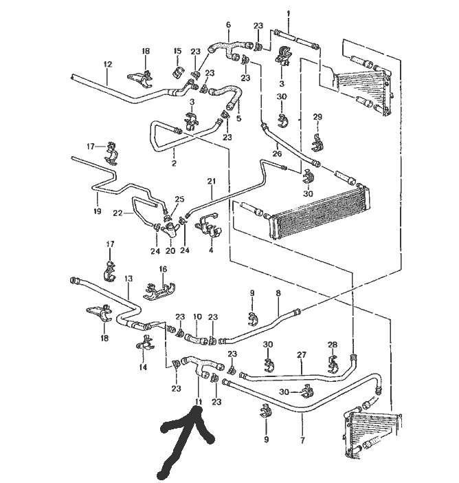

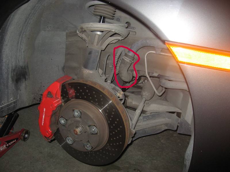

Does anyone know the part number for this coolant hose?
Front passenger side... Thanks!!!!

Hard to say for sure from the parts catalog but maybe 996 106 502 74
Start looking on page 35 (KAT 23) in this PDF and go from there a few pages forward as well to the radiators:
http://www.porsche.com/all/media/pdf...SA_KATALOG.pdf

Thanks for the link. Man I am confused though. Hard to tell which one it is. lol

I took a look at the diagrams and still cant pin point which one it would be. I even sent a pic to the local Porsche dealer and they couldn't give me the Part number. LOL
Anyone?

I was looking at my car a2002 TT. If you look closely at the pipe , it is a Y going to the front radiators and after the Y it is a rigid metal line. So it has to be item# 11 from the parts catalog which is #996 106 728 72. $26.48 at Sonnen....

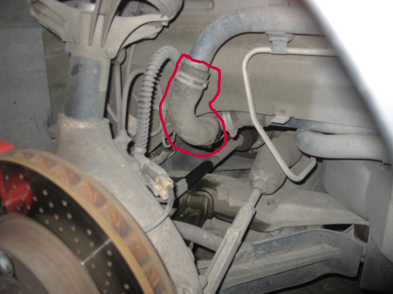

Thanks for ths input. Although the hose is not a Y it is a 12" hose with about a 90 degree bend in it. Right when it attaches on one end though there is another hose that attaches to the same T so I am thinking from the pic you posted it may be #5.

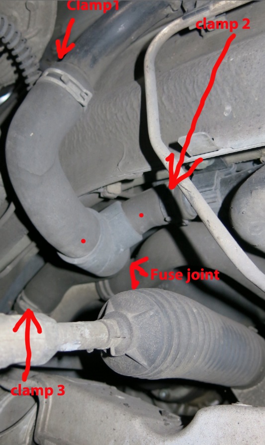

Went to take a picture of my set-up. I got a Y with three clamps. The middle part is a triple fuse joints and the pipes cannot be separated because they are manufactured that way. But may be your set-up is different..... I can see on your picture a clamp that is not OEM.....

1st of all thank you very much for taking the time and trying to help and even going out of your way to take pics. I noticed mine had a worm gear clamp which was different than the spring clamps that came OEM so now I am thinking the original owner modified it for some reson. This is becoming a pain.

#11 is shpwing as a left side hose so if anything I guess it would be #6 which shows as a right side hose.

Good point. It is really strange because the view shows the lines going to the left which should be the back of the engine. I've check the Porsche catalog and they mention left also for #11 and right for #6....Hum... I am a bit confused because #27 is right side....I personally would like to order #11

Yet # 7 is Left side. This is a mess. LOL
Well armed with your pic and my pic I went to the parts counter and we are 99% sure it is #6 we need. The good news is although the part numbers are different #6 and #11 look identical.
Thanks again for your help. I would have never figured it out without your pic showing that the old owner modified the hose.

I just checked and even though #6 and #11 look the same they have different part numbers and prices so they cant be the same. Well I orderd #6 but if it turns out it is wrong and we need #11 I am sure my parts guy wont have an issue doing the exchange.
