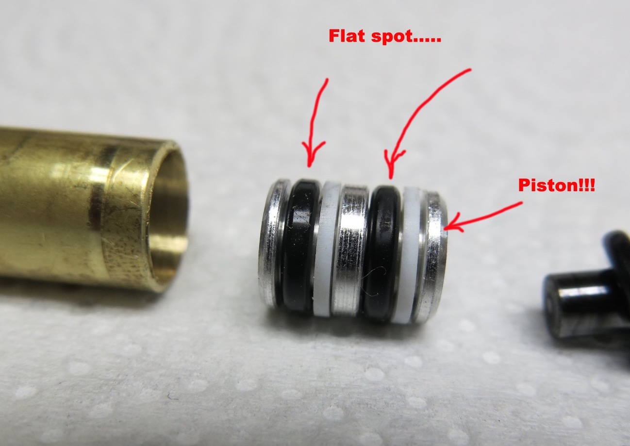

Just went through this and successfully fixed mine. I went with the Lucas ps stop leak and ps fluid mix. When I put it back together I was still getting driver side lag and partial deployment. If you take the pump apart you will see that the syringes hold a small amount of fluid, and if both chambers are not equally filled you will have partial deployment. Run it and fill it a few times and they should equalize. I cracked the banjo bolt on laggy side with spoiler up and although under pressure I got the air out. Just have some towels handy. Then I refilled and spoiler operates perfectly.
Good luck. Exactly what I did a few years ago. Lasted a few months then blew. Pentosin all over the back bumper. Ruined my paint a bit.

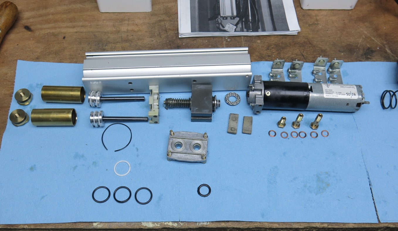

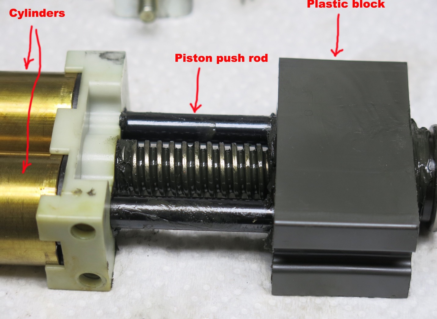

You have to be careful when you are filling the system. The system got an electric motor that move a black plastic block and this block push two pistons via rods and if one cylinder is empty there is a risk of breaking the block because of uneven pressure..... I just completed the overhaul of a complete system and it is under test now....The seals used by the manufacturer were of a very bad quality especially the ones inside the two actuators.
so many things that can fail...and this just the motor and plungers! ;-)
