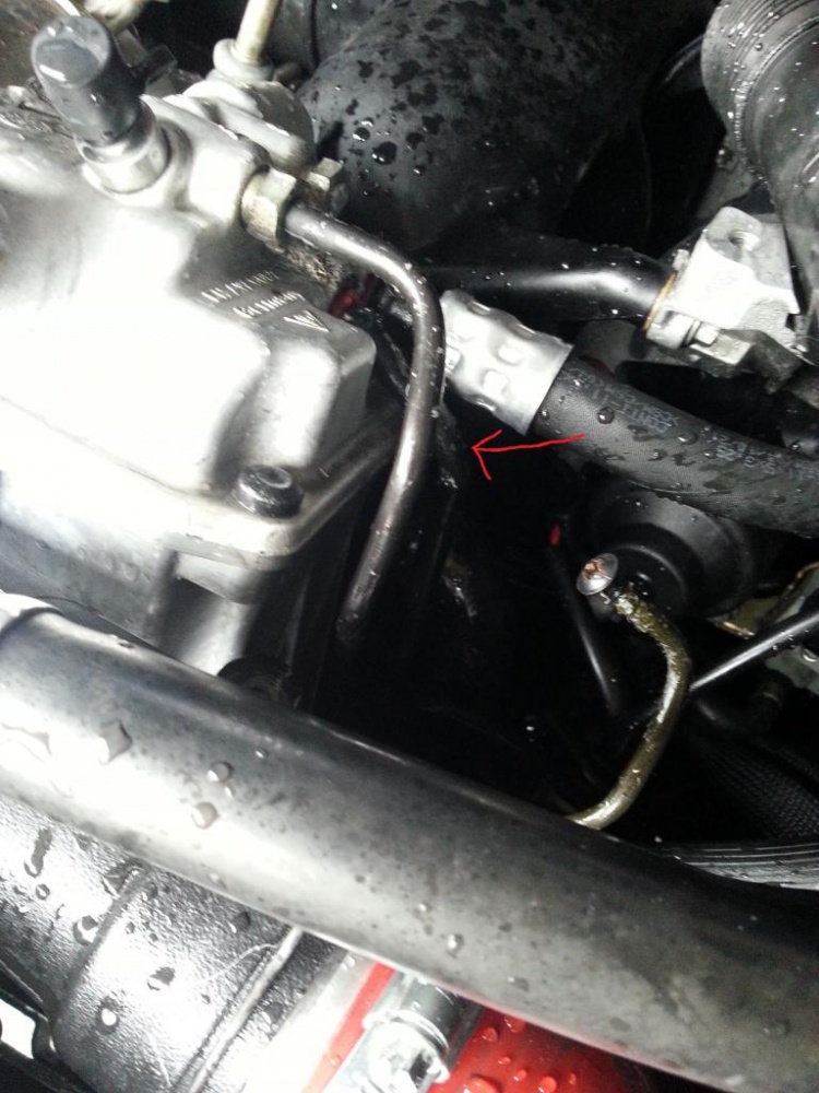

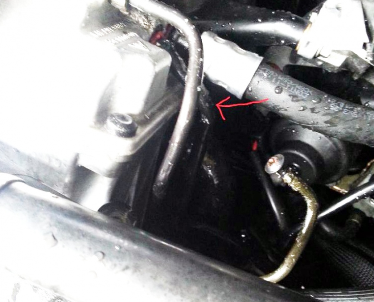

Hi Guys my car has the GT2 Slave conversion, its been fine for 18months, but last night one of the pipes started leaking real bad. I nursed her home, I was only 5miles away. Had enough fluid not to run the pump dry. I cannot find the part number for this pipe for the life of me. Please help!
The pipe that is split and leaking......

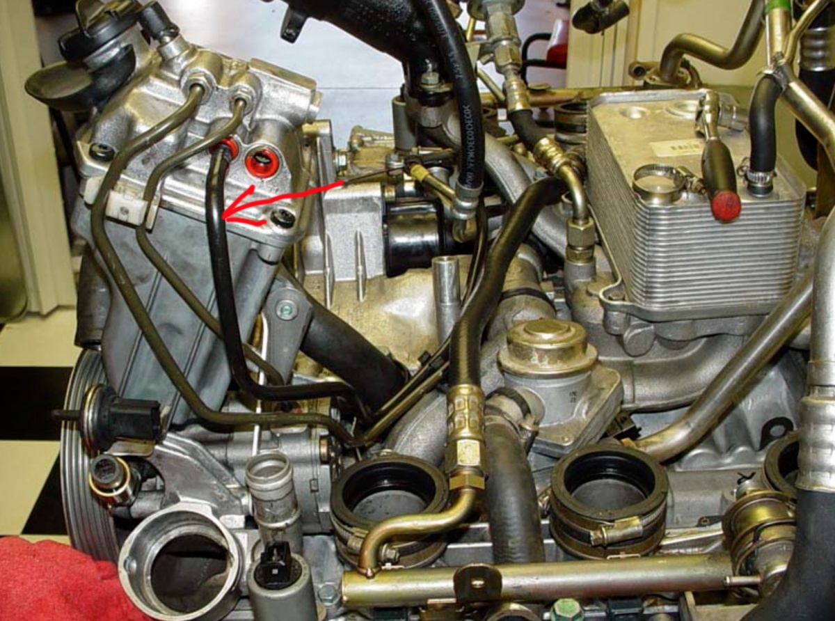

Hum...I removed a bit of contrast from the picture and the arrow seems to be pointing towards the middle rigid line.

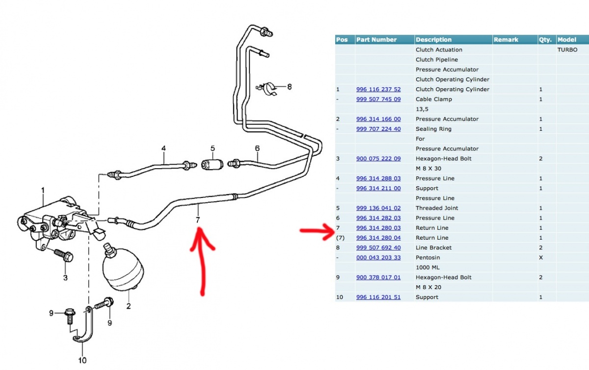

If it is the middle line which is rigid, it is a long line going to the slave (gt2 conversion ?) ....Part# 996 314 280 03 supersede by part#99631428004 $79.75 at Sonnen. Must be a very good job to replace.... Is this line still in used with the GT2 conversion?

JP flip the pipe u identified in your edited pic is indeed the one i require. it does not go to the slave cylinder. it is a power steering pipe.

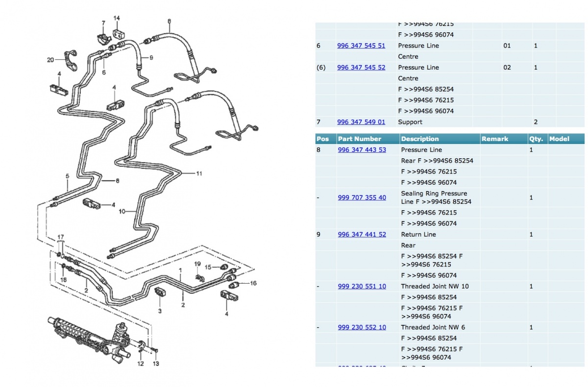

Very hard to see on the parts catalog. I am trying to locate the other two lines going to the steering rack but it is very difficult. According to this drawing items 8 and 9 are steering pressure and return but the shape of them seems to be different....The black line has to be return....
