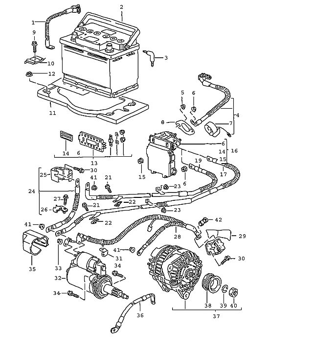

Having spent hours of research and jacking the car up and down, I will call this my last report because I've had enough of test car and that’s it if I still cant get it fixed by next week.
Last night, I carried out the final voltage and resistance tests with cold & hot engine using the multimeter based on the 996tt electrical diagram attached.
Let me list out the possible problems with my low voltage symptom.
1. 85A battery (new)
2. Bosch alternator 997-603-012-06 TIP (new)
3. regulator & alternator pulley (new, comes with item 2)
4. alternator to starter hardness 996 607 03 204 (no.2 Test 1
5. engine ground strap 996 607 034 01(no.36) Test 2
6. –ve battery lead 997 611-090 00 (no.1) Test 4
7. +ve battery lead 996 612 090 09 (no.4) Test 4
7. long cable from starter to ECU 996 612 044 00 (no.19)
8. engine terminal to transmission terminal 996 607 033 02 (no.24)
So I focused on testing on no.24, 28, 36, 1 and 4. Not, 19 because I cant actually see it. According to the diagram, I assumed no.29 = +ve engine terminal and no.25 = transmission terminal.

It seems to me all the cables are in good order. Who can help me to solve this my low voltage problem?
