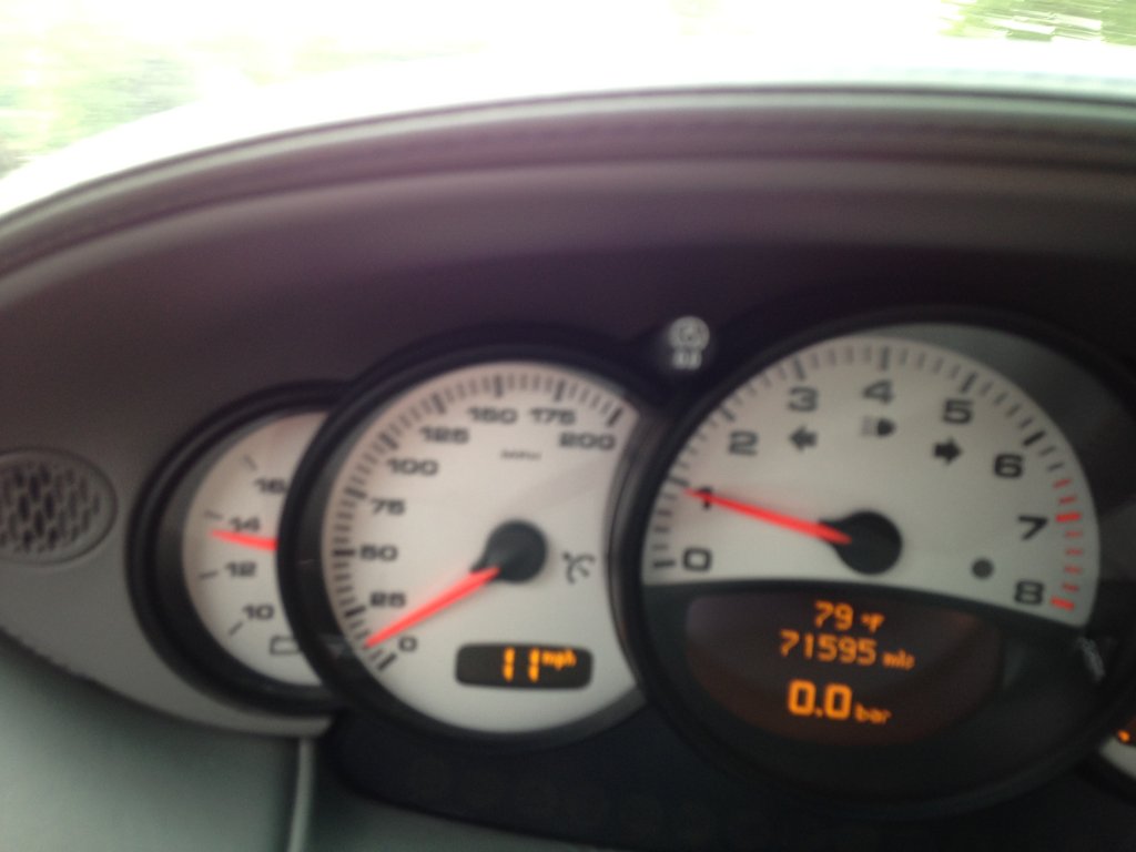

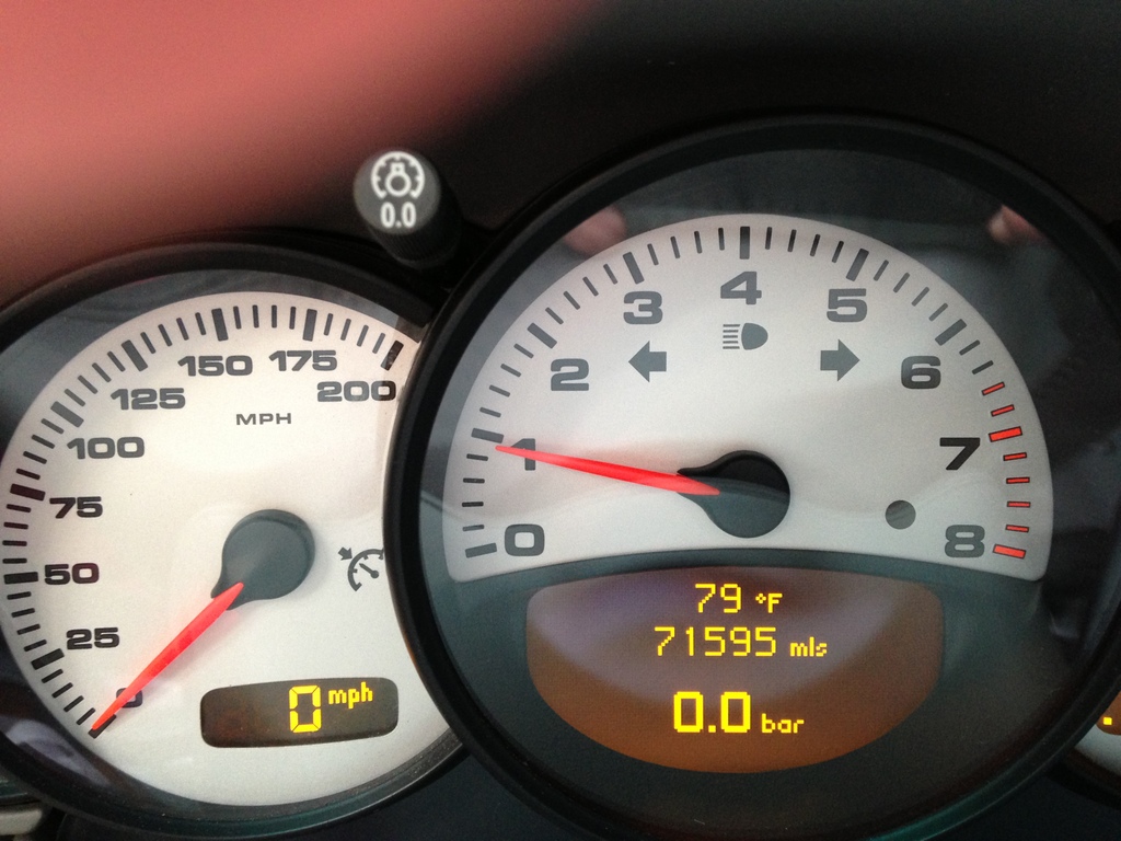

More info.
At idle, upon cold start - it will hunt a bit between 1k and the first hashmark below 1k. Will settle to here, just below 1k =
I tried coasting in gear in 1st, 2nd, 3rd - all exhibited the same problem where I would not coast to a stop / stall - I kept going. In second gear, the tach settled here as I continued forward - just below 1k, speed was maintained - registering 10mph
When I took it out of gear, there was a small blip to just over 1k, then back down.
Also, which may be of note - I do have a 964RS LWFW and Clutchmasters clutch. The previous owner had a custom tune done at EPL after this work, assume with the LWFW, the tune needs to play with the Rev settings so you don't stall. My idle RPM number has always been here since I got the car - assumed this was normal. However I had never noticed the continuing to move when in gear and off the throttle.
