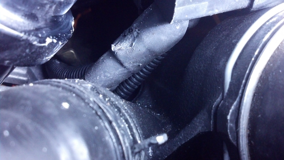

update. put the new alt in and still shorting out problem. found it last night. I had put new diverter valves in and they were aluminum not plastic like the original ones. behind the positive termainal in the engine bay it had worn off the insulation and was now contacting the diverter valves some times. the diverter valves were tight enough to make contact with something else to short out sometimes.

Wow good catch Pat!!!! Had the same problem with mine , the head of the new diverter valves was a lot bigger and had to provide space for the new ones. And it is tight in there!!!

I taped it up and put zip ties over the top. should be good now.
