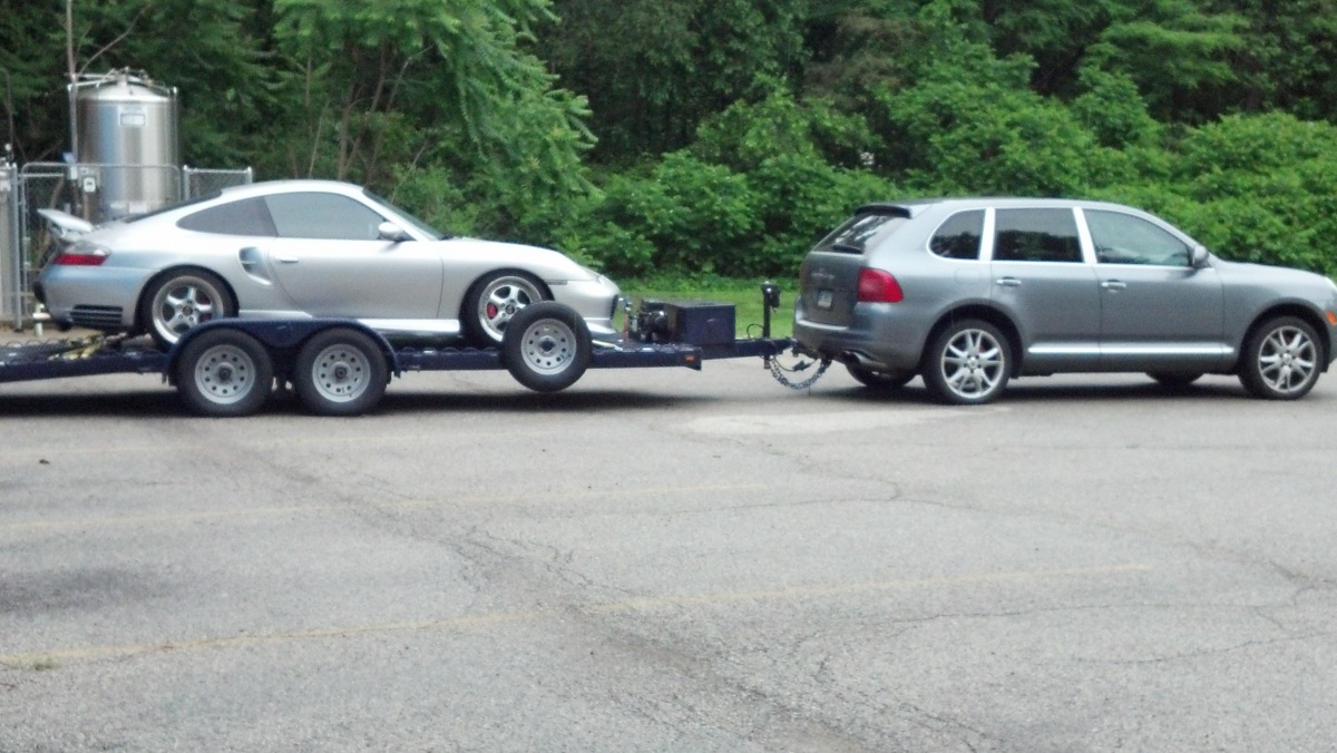

loaded to get home

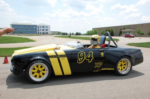

slightly off topic but so rare to be at a computer to put some pictures on. beat todd in his track only car by .004 sec auto cross sunday at the tire rack.. picture of todd. supper sweet car. realy good driver.

loaded to get home
Fully equipt Pat!!!! Love it!!!!
