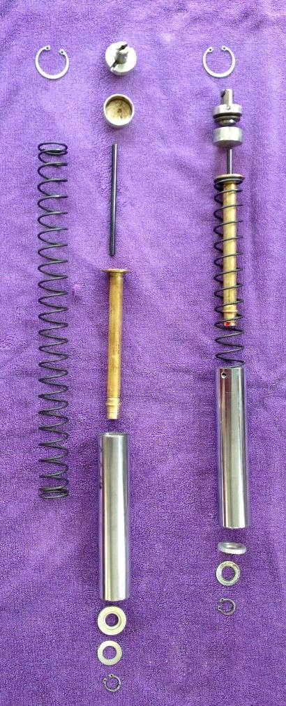

Here's a quick update.
The 3D printed part will not work in the material we used as it can't handle the heat. I'll have to decide if we want to change the 3D material or just have it made the old fashion way.
I disassembled the rams for the wing today. Unfortunately I found out something I remember reading over a year ago. Below you can see the disassembled rams for the wing. Please don't try to disassemble your rams as they are under a lot of spring pressure.
The issue is the rams can't be disassembled. If you look, they have a ring pressed into them that stops the pistons inside the ram from moving.
I have an idea of how to remove the piston, so the seals can be replaced, but I'm my try a little more stop leak before I try the modification.
Later, Steve

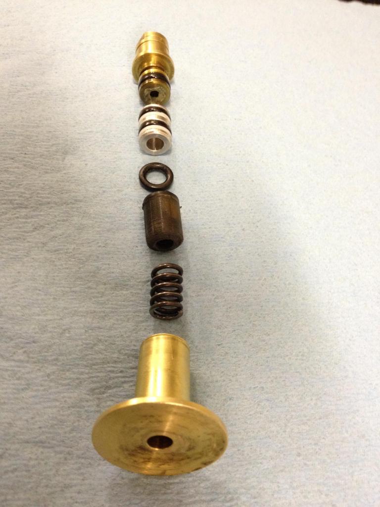

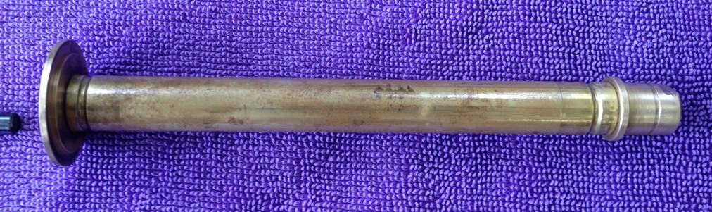

Thanks to James, we now know what the inside of the ram that lifts the wing looks like.
Unfortunately there are not only o-rings on the piston, but also on the fitting pressed into the lower part of the ram.
I solution is still possible, but will probably require some machine work.
Below is a picture of the guts of the ram.
There is a little more going on then you might imagine.
There is a spring and o-ring that are at the top of the cylinder.
http://i260.photobucket.com/albums/ii28/sjarvis0225/image_zps4af5df43.jpg[/URL]
More updates later.
Steve

Glad I could help expand the knowledge a little bit more. I have another ram if you're ever in need of one. Hopefully the knowledge gained not only identified where some of the problems are coming from, but perhaps even stimulated an idea of a better replacement. In any case great work steve.
James

Steve Jarvis Is a GOD !Steve Jarvis Is a GOD !Steve Jarvis Is a GOD !Steve Jarvis Is a GOD !Steve Jarvis Is a GOD !Steve Jarvis Is a GOD !Steve Jarvis Is a GOD !Steve Jarvis Is a GOD !Steve Jarvis Is a GOD !Steve Jarvis Is a GOD !Steve Jarvis Is a GOD !
I definitely think there's an opportunity for a two piece cylinder (instead of the current three piece unit). This would eliminate the o-ring at the bottom of the cylinder and the top could be screwed off to replace the piston seals.
Thanks again.
