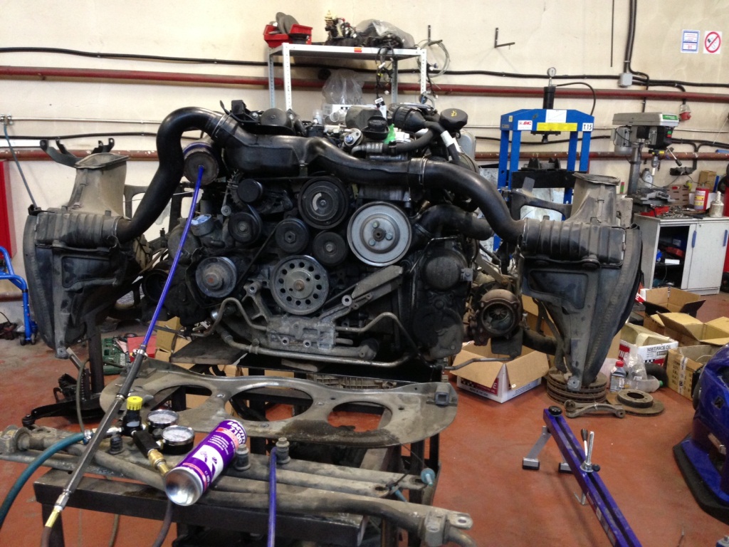

The story:
I Have USDM 03 996TT with K16 turbos.
I had a problems with a boost level - so maximum i was running .5-.6.
So i decided to drop off engine and to do everything we could.
We did a boost leak test aaaaand:
changed 5 hose clamps
2 returning valves were leaking
Y pipe on the top (near diverters) Ejection Pump
tested Fuel injectors in laboratory
Installed new HKS M35 Spark Plugs
changed Actuator ROD position a bit
installed RS4 Diverters (Kayser)
made De-cat stock exhaust
And Cleaned the engine, before returning it back to the body

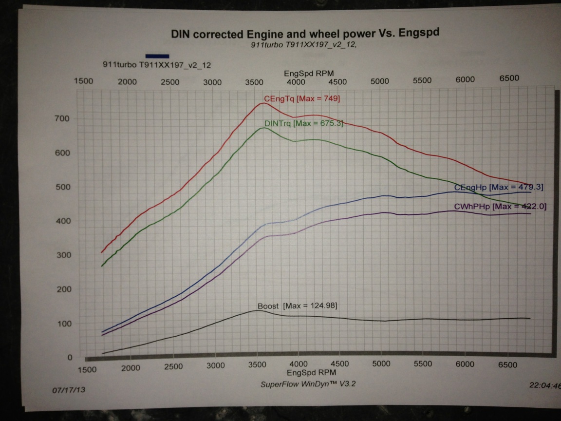

Annnd the main interesting part now
We moved car on a Dyno stand and started to tune.
So here My latest result made on 98 octane pump gas (your 93 octane analog, but with more worst quality).
One thing we really need to change is the overboost on 3500 RPM. I guess if we could go normal boost there we could not have small retard in HP (it shown on HP chart) and build more HP a little bit earlier.
How it looks like guys ?
