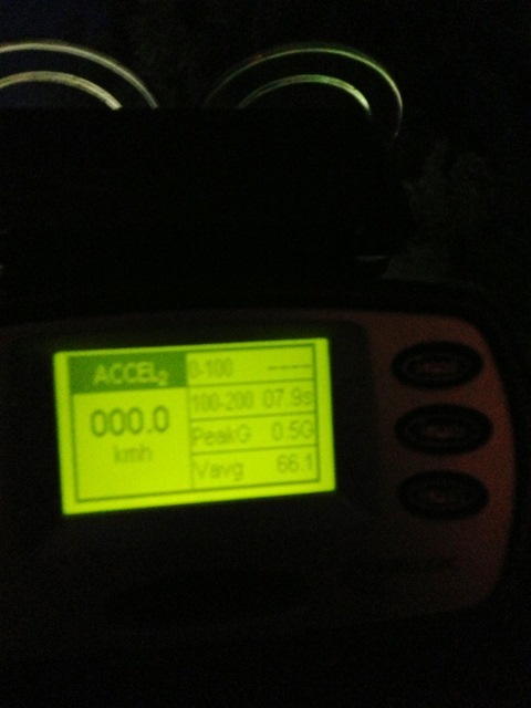

Hi all , today I floor it all the way since I own the car (10) days , I had RL in the car , my 100–200 km/h madness , 7.9 seconds
turbos 18g/24 , 58lb injectors , not sure about FPR . new Forge intercoolers on the way , what should run healthy 996TT on this set up ? boost on the dash 1.1 , sometimes 1.2 not often . Thanks you

You must have a serious boost leak or some issue with the car. I have 18g and im in the 6s range.

could be the oil in the intercoolers after overfill ? I'll check for boost leaks on the week end , thanks

Markski sells a nice Boost Leak Tester Kit... i'd start there plus its good to have.

thanks I'll buy it , if there is no leaks , what should I check next ?

have a durametric? you can get codes without a CEL.
Spark plugs, coil packs, map sensor, N75 valve, these are all common / possible problems.

no codes , no cell , engine sounds great , N75 ? the boost looks fine on the dash .

Who did the tune? 91 or 93?
It's likely a boost leak.... common, and you'll find them in places you wouldn't imagine.
Get Marski's kit, its super easy to do.
The turbos are still going to try to produce 1.1 or 1.2 bar, whatever the tune is set for, regardless of a leak. They just have to work harder to maintain pressure. Even a small leak and rob you of some serious power.

Tony EPl , 1.2 I think , I hope it's a boost leak , the oil in the intercoolers might cousing that , new ones on the way , what can be the gain with better ignition timing?
More power? lol
600's aren't uncommon with 24/18's... 7.9 seems... well... slow. I'd say high 6's are realistic. Also, 1.3 bar will make much more than 1.1-1.15 - probably 20-35hp range. I find that dash gauge to be pretty far off compared to my EBC.
Boost leaks are common. I test my car every 2-3 months. It's 13 years old, sometimes things break.

It's not just the car fairbird. You're not going to run a record 60-130 within 10 days of ownership. Go out and practice before checking for problems. 7.9 is not bad actually on such little mods.

You need a Pbox. How do you know you're in the 6's?
