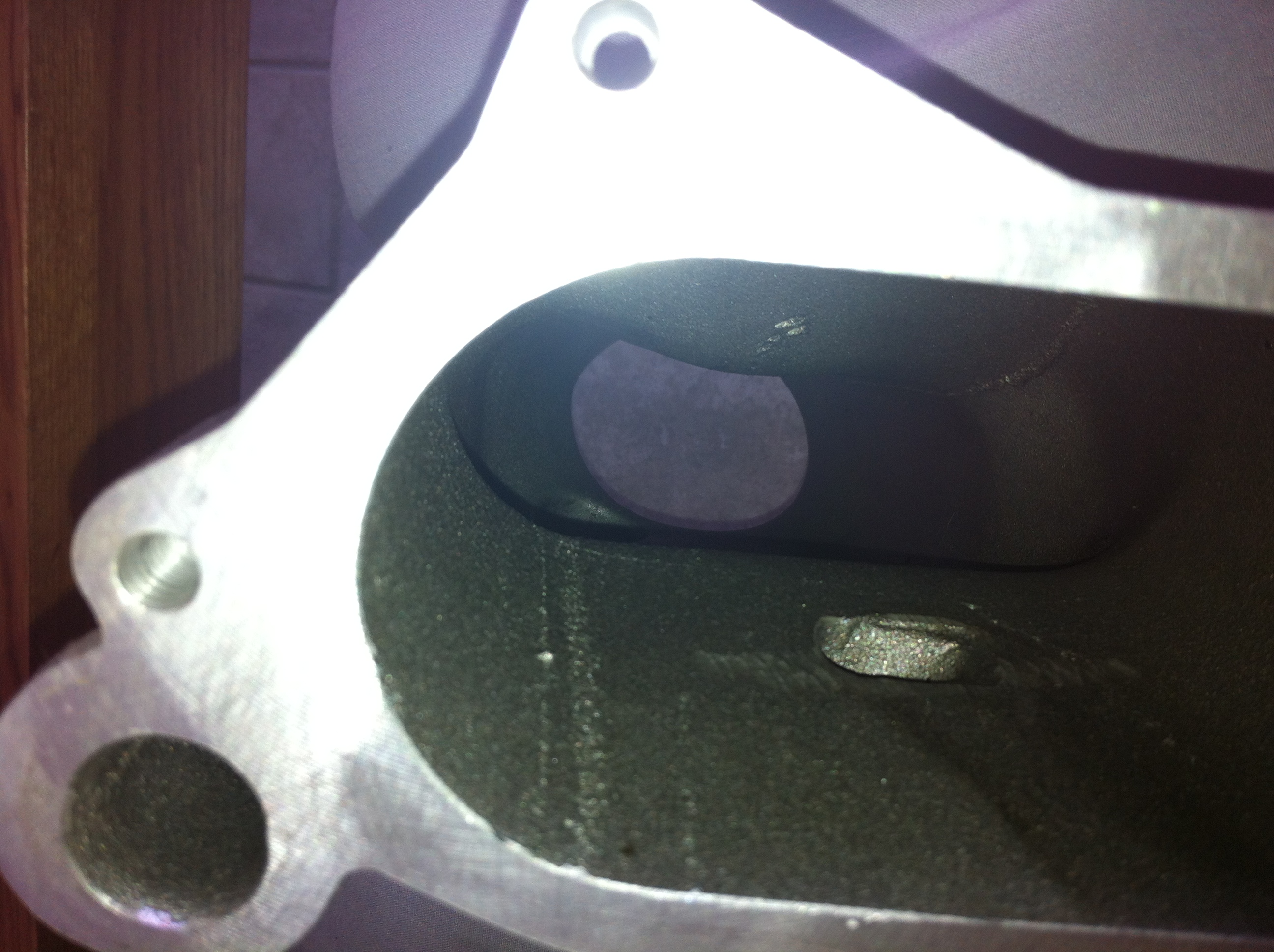

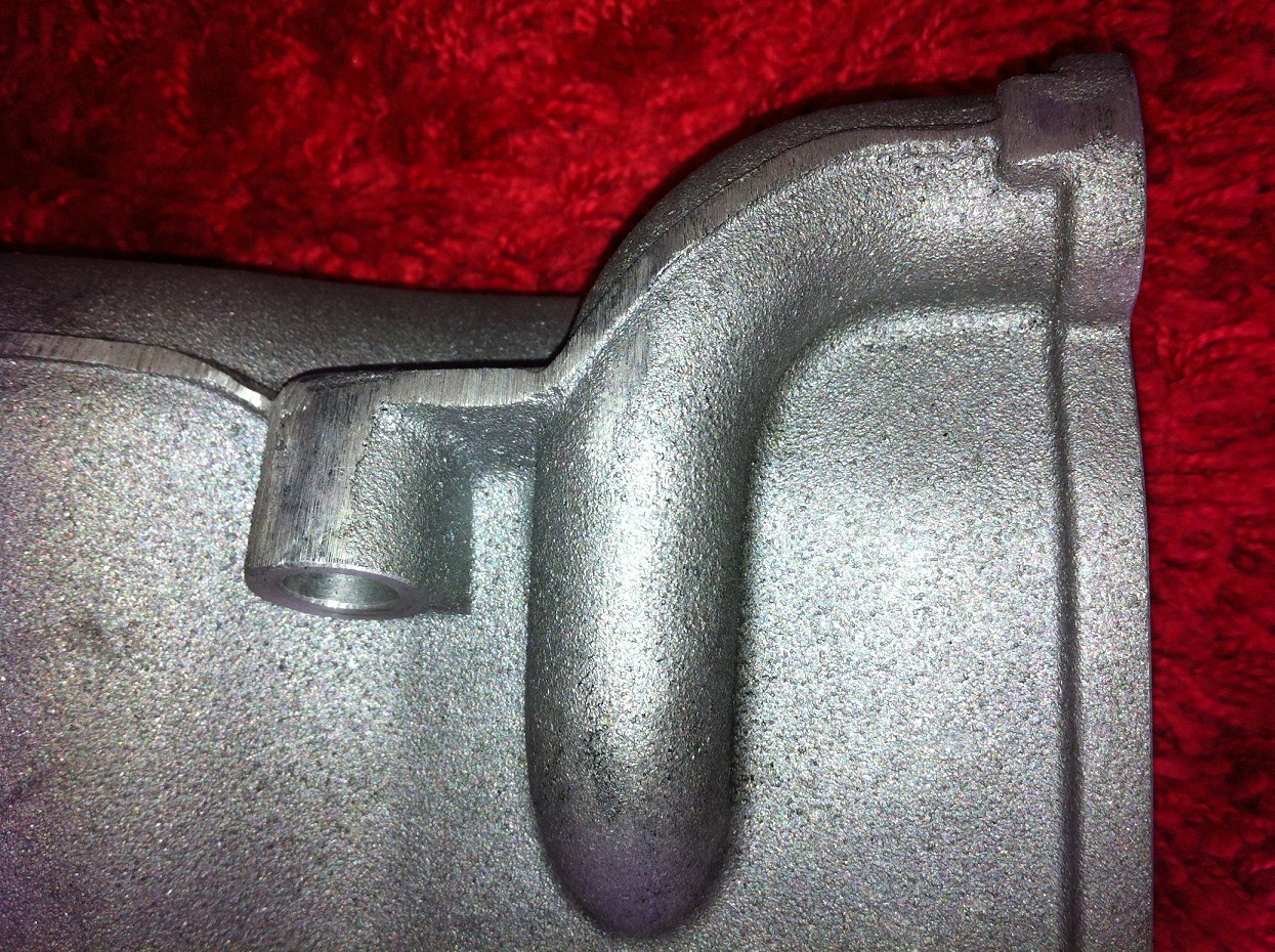

Originally Posted by winnigt2
if you are simply overfill your oillevel you can get get oil in your boost hoses too, because the overfill line goes into the intake boost hose

Originally Posted by 996tt550hp
Ummmmm plz take a pic because i see all of my hoses and no lines go in there.
follow the small hole at the intakeplenum and you find your oiltank....pictures attached
and exact at this point overfilled oil at hot engine goes into the intake tract
I just asked if we had and oil fill drain at Porsche they said no. I have over filled mine and I never had any oil in my pipe so I recommend to get your turbos checked.
