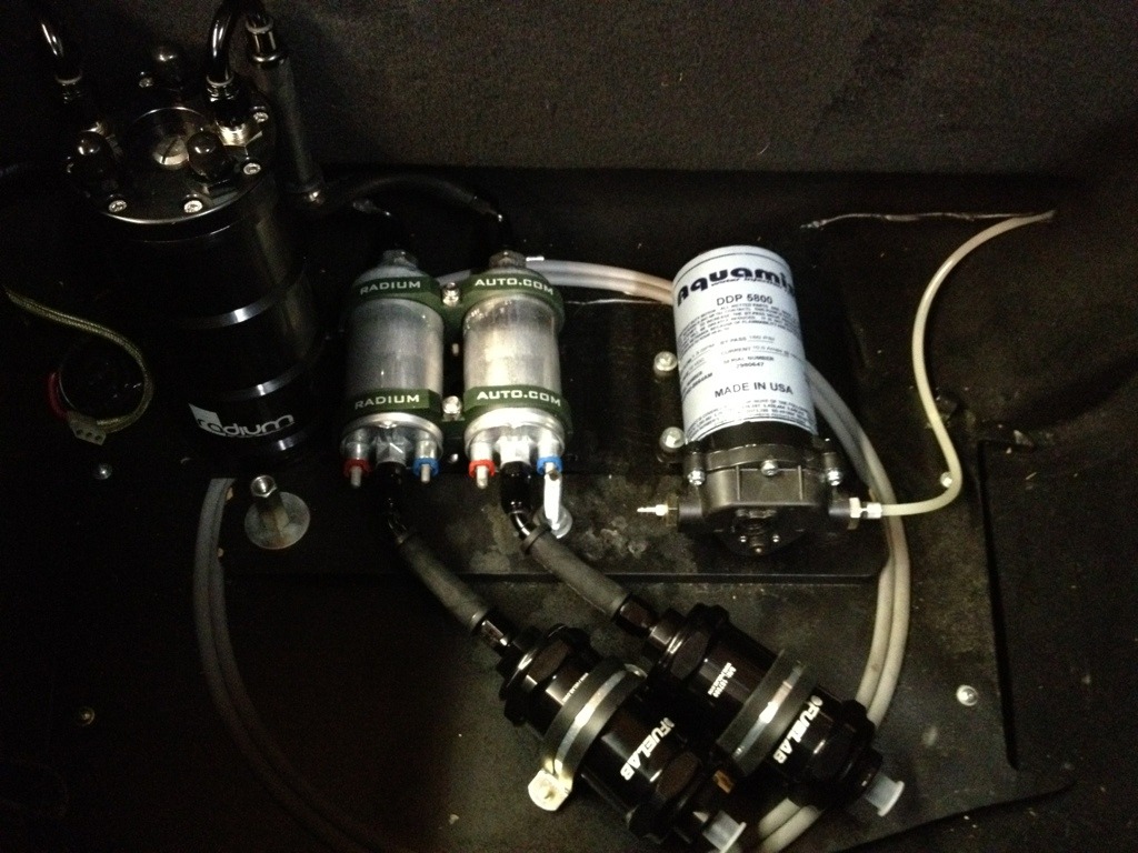

Originally Posted by prodigymb
I use two FueLab 1800hp Prodigy pumps with an electronic FueLab pressure regulator that ramps them up as needed. No surge tank here. FIC2150cc injectors and custom fuel rails by The Tim.
prodigymb, when did switch out the radium surge tank with twin pump setup pictured below? and why?
https://www.6speedonline.com/forums/...-here-how.html

Originally Posted by BiteEmNBeatEm
prodigymb, when did switch out the radium surge tank with twin pump setup pictured below? and why? https://www.6speedonline.com/forums/...-here-how.html
When I made more power then before and figured out that's what was holding me back. That setup is good for big power on race gas but on e85 it's good for under 775whp or so. Need to move a lot of e85 to make big power on it.

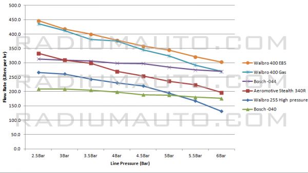

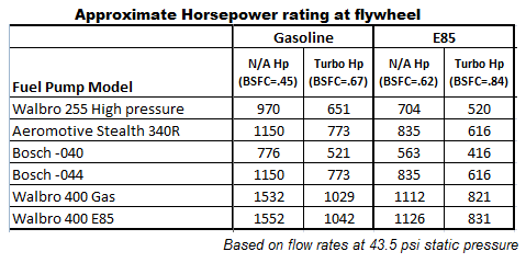

You probably know something I do not.
Full Article:
http://radiumauto.com/media/techarti...l-Pump-Test-87

Single setup and what helped me started with mine (pic is not my car). Hope it helps.
