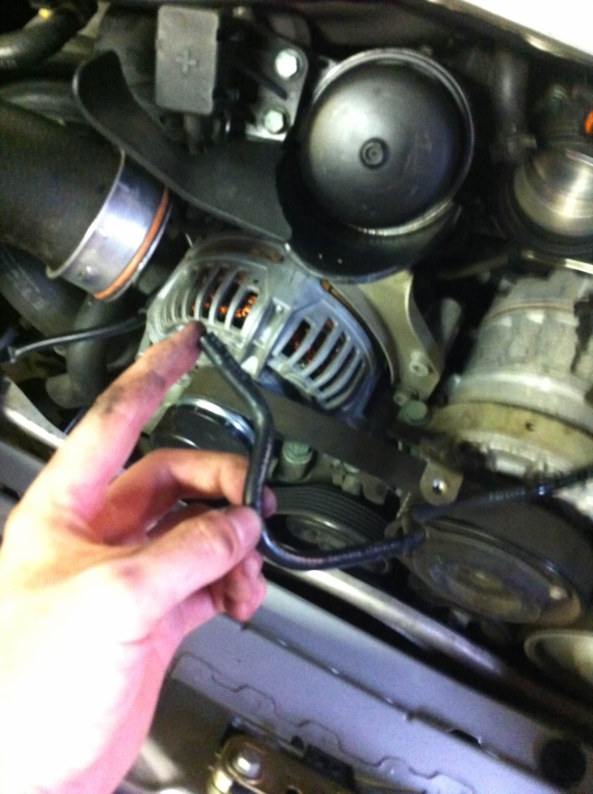

Just removed the y-pipe and cleaned the throttle body. Now, I noticed the small hose in the photo is just very loosely inserted into another hose and you can pull it out without effort. I don't see any sort of hose clamp anywhere so I'm wondering if this is normal???
The opposite end is connected to the N75 valve and is not loose.
Thanks for any input!

Yeah I think that is the one that goes into the "F" hose - it just press fits in. Surprised it does not blow out, but must be a low pressure line I guess.
Page 52, item 42 in the Katalog:
http://www.porsche.com/all/media/pdf...SA_KATALOG.pdf

I think I put a clamp on mine .
