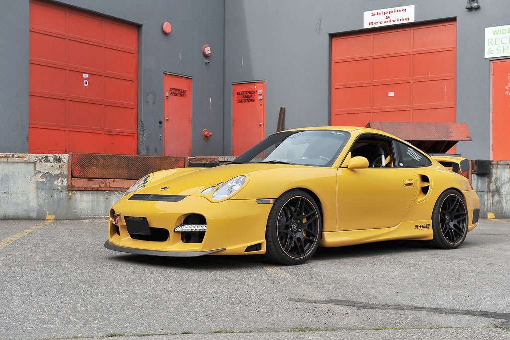

18x9 and 18x12 is a tried and true set up used widely by a majority of 996/997 GT2/3 track guys. That's what I use. 18x12 with ET41 offset and 18x9 with ET47. I do however have 11mm of shims on my front LCAs which pushes the wheels out increasing camber and widening the track. ET40-45 with a 18x9 works well. This is what the set up looks like to give you an idea:
Thanks for the visual, thats whats missing from most discussions about fitment on here. Two more questions though, do you get any rubbing anywhere and how much camber are you running up front there, looks like a lot.
No rubbing whatsoever. Camber -2.7F and -2.2R. Even with milder camber there is no rubbing. My car has GT2 fender liners front and rear along with rolled fenders. Ride height is 1/2" below GT2 at 101mm front and 120mm rear. If you stick with ET 45 in the front with 9" wheel (as opposed to 40) you will have good clearance. Hope that helps
