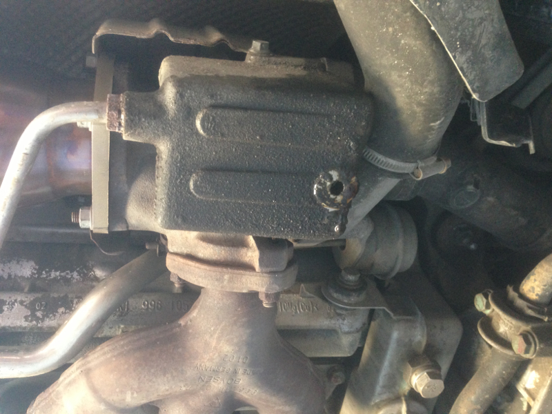

Started to get a very small leak from under the passenger side turbo I assume this is part if the turbo oiling system. Anyone have this issue? Fixes?
The drivers side is bone dry.

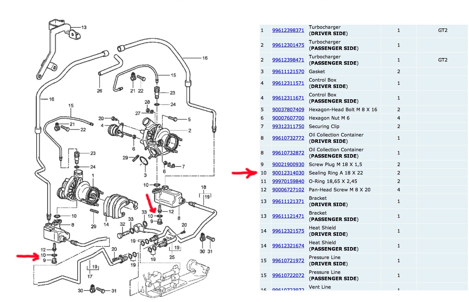

crush washer on the drain plug needs changing

Agree with 32 Krazy! You got a damage or missing crush washers part# 900 123 140 30.Easy job to replace (allen key 8 mm) and just a little bit of oil will come out. The torque for the plug is 22 ft/lb.

it could be the washer! but i am more worry to see the side tank wet look like it maybe coming from the top of turbo! it can be the check valve leaking to

I cleaned the oil away so I should be able to see where it's coming from.
