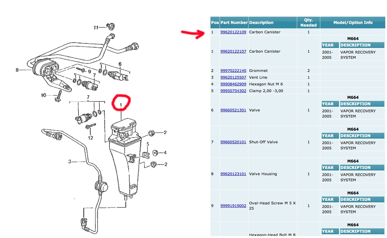

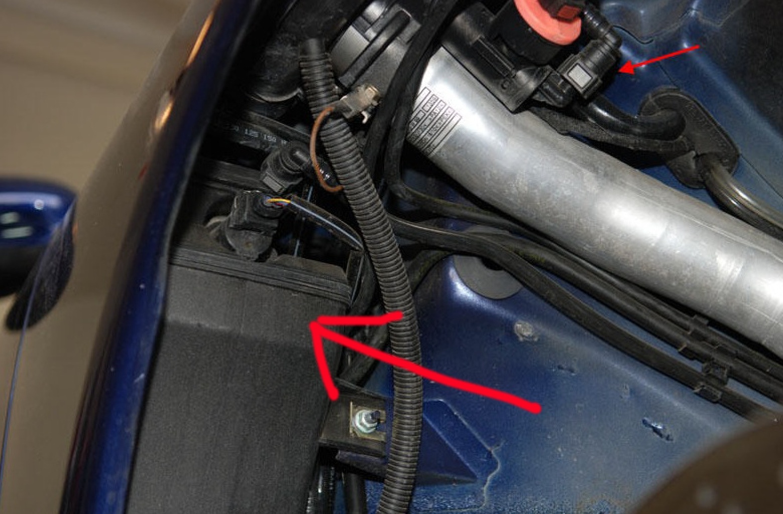

Charcoal canister location: Right hand wheel well, aft end under the plastic lining.
Name:	Capture d’écran 2013-10-22 à 02.19.50.jpeg
ID:	292040   Click image for larger version
Name:	Capture d’écran 2013-10-22 à 02.19.17.jpeg
Ahh.. Looks like a easy replace. Is it that one nut holding it on there jpflip? Also, Would I need 99620122107 or 99620122109 ? There are 2 Number 1s. Thanks

Sorry , got no experience with this item. I just tried both numbers with Sonnen and they both works???? And the 99620122109 as been replaced by 99620122108....But my guess is the second one is the right one. M664 means, Onboard Refueling Vapor Recovery (ORVR)...Once you got the wheel well lining removed you will get all the plumbing, vent lines, gate valve etc. that are part of the fuel system. May be you will found something else at fault.
