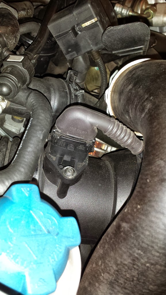

I'm pretty confident that the car has stock sensors and fuel system but I can always use your guy's help to confirm.

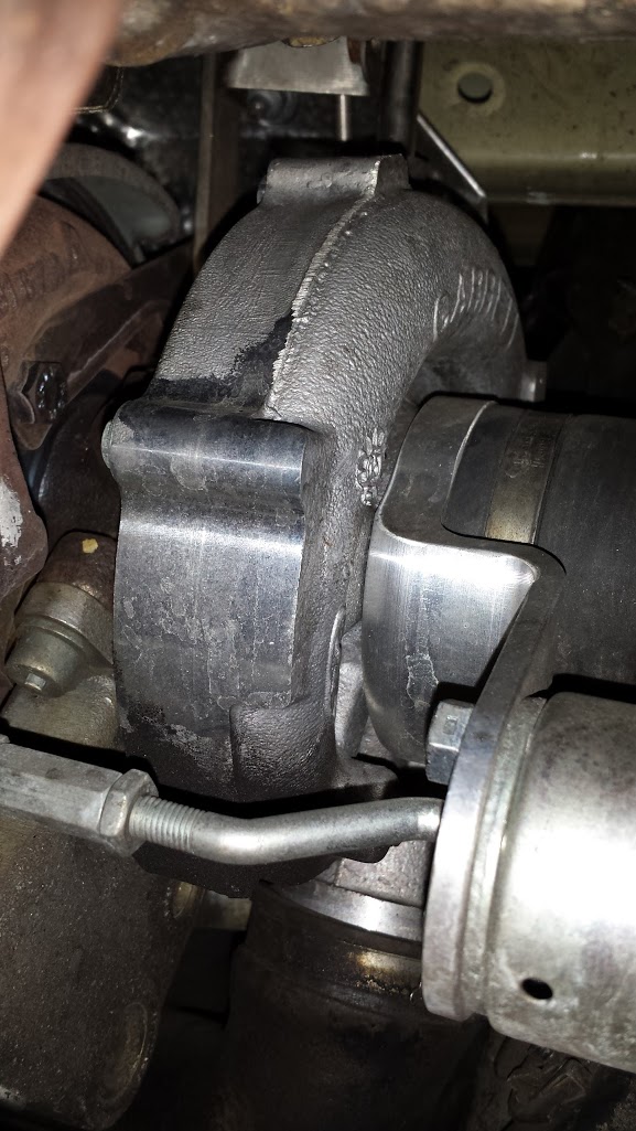

Picture time:
MAF:
TB Sensor
Injector
Not so great pics of turbos but might have enough clues for you guys to identify (will have to jack up car to do better)

those actually look like the old K16/28 hybrids which were the predecessors to Alpha28s which have Tial Stainless hotsides. Not ball bearing and basically uses K16 hotside. Like Tony said stock maf and stock injectors is what u have.

She does have a water port, but it's not plumbed. Does that mean these are BB CHRA's? I will address the water lines if I stay with this setup.
Which puts me at a crossroads. Part of me wants to just swap to a some billet K16s with tune, sell these, and call it a day. Other part of me wants to stick it out with these, as even though they are the older A28s, they are probably still technically superior to the K16, K24, etc turbos in terms of spool and top end. Or are they?
Some reasons are that this is ultimately a DD, and I only need so much power. Also, it's a slippery slope of mods to support more power - injectors, clutch, etc.
If I do stay with these, any recommendations or injectors/5bar/tune? Which tune as I'm not sure which company has the most experience with this specific turbo?
