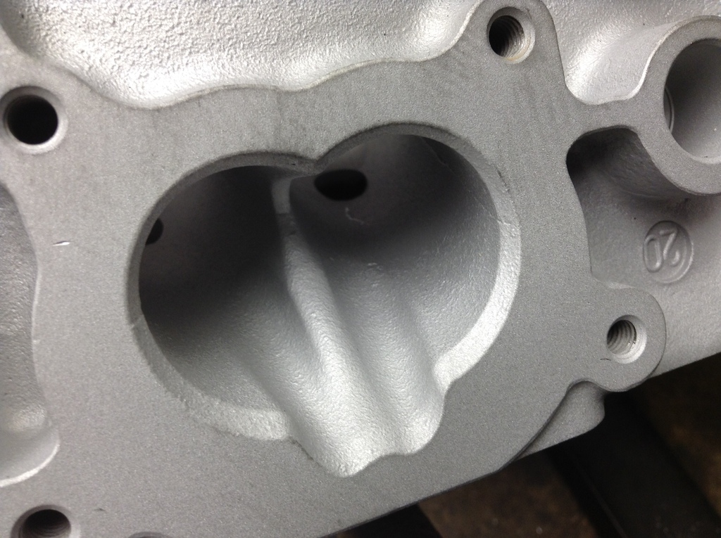

HeadGames has been doing 996/997 heads for some time now, doing them for various shops. Now, they are available to everyone! Follow this thread and see the process and learn how a head is built!

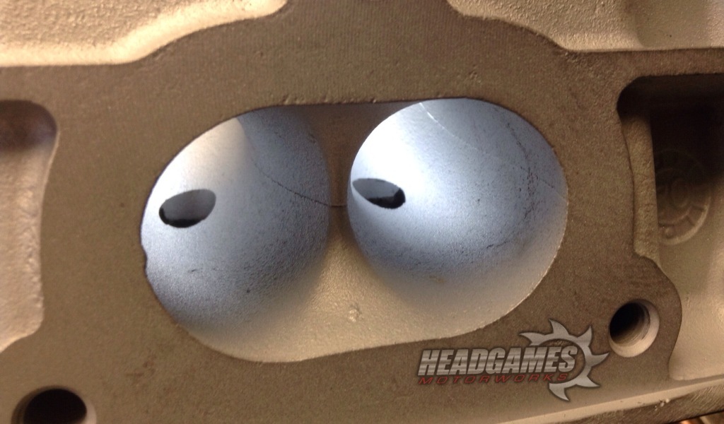

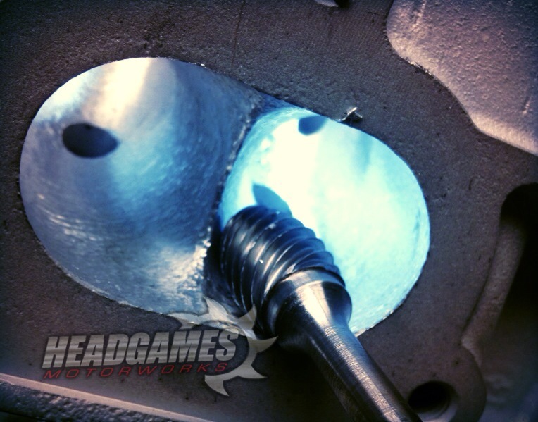

Flow testing is a integral part of cylinder head development, because of time constraints. We do not flow every head that leaves the shop, but extensive testing is done to get the valve job and port shape right where we want it before moving forward. Here HeadGames shop manager Tiffani is flowing the stock intake port of our 996 head to get a baseline.
Stock 996/997 intake port
Roughing in the intake port, with a lot of room for improvement in this casting. Especially the intake side!
Stay tuned next week for more updates!

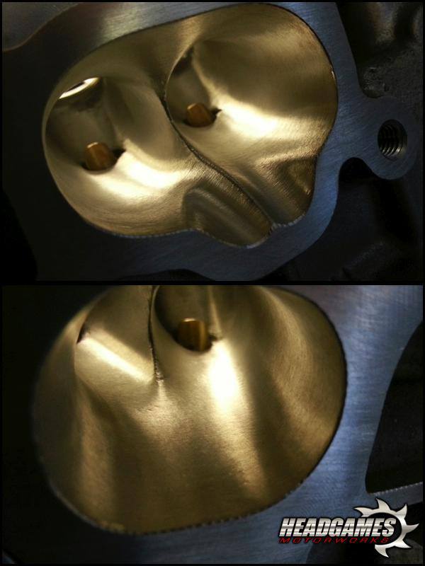

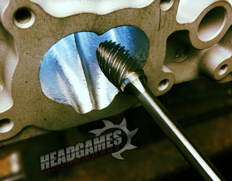

exhaust port is ready for sanding!
before
after
More pics tomorrow!
Custom tailored HeadGames guides should be done Thursday
