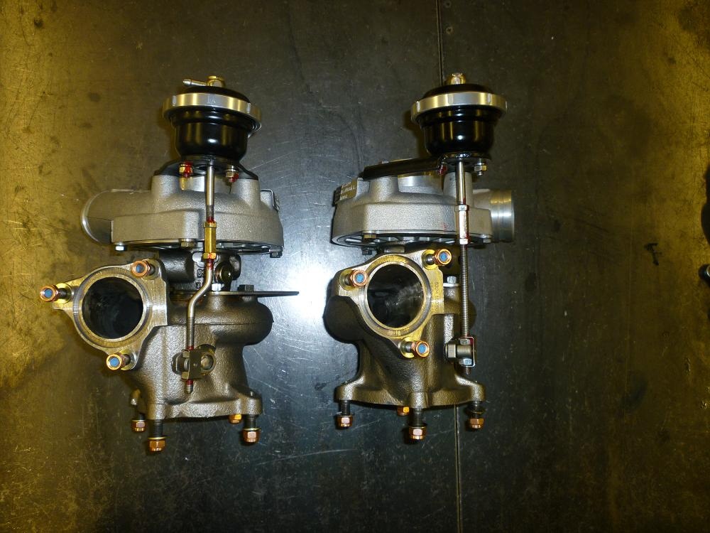

Got those nice IWG-75 actuators on brand new turbos.
Proto were great, I just thought my set up was perfect, until recently and they obviously checked the lamdas. And it is not like the power is not already huge.
my last attempt, can anybody actually explain / confirm if the actuators are supposed to keep the wastegate closed, until it is about to hit set point pressure ? A N75 valve is v fast acting, so I would have thought this closed loop control system would only give a very small boost deviation, not like 0.2 bar, as I am seeing unless there is fault/leak. I have a log from when the engine was rebuilt and it is exactly the same as now.
