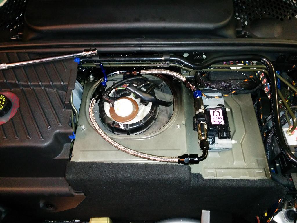

Yep.
Old Feb 15, 2014 | 11:43 AM
e8_pack's Avatar
Joined: Sep 2013
Posts: 123
From: UK
e8_pack is a jewel in the roughe8_pack is a jewel in the roughe8_pack is a jewel in the roughe8_pack is a jewel in the rough
The quick connects to the fuel pump are 5/16, but they are shallow and my 6an coupler won't fit so I need to get a new quick connect from pump and a rubber hose as I have PTFE to my 6an fittings.
