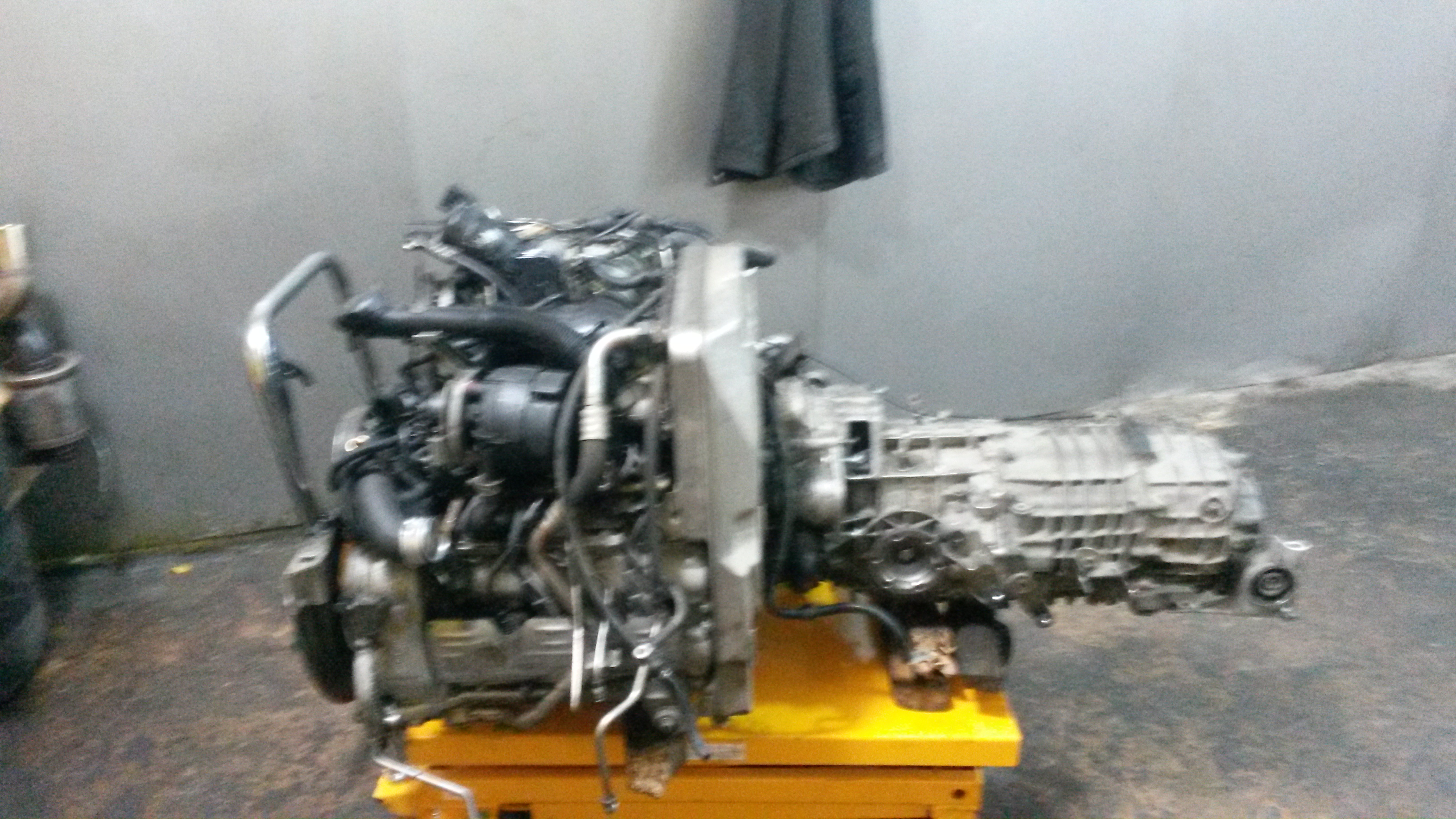

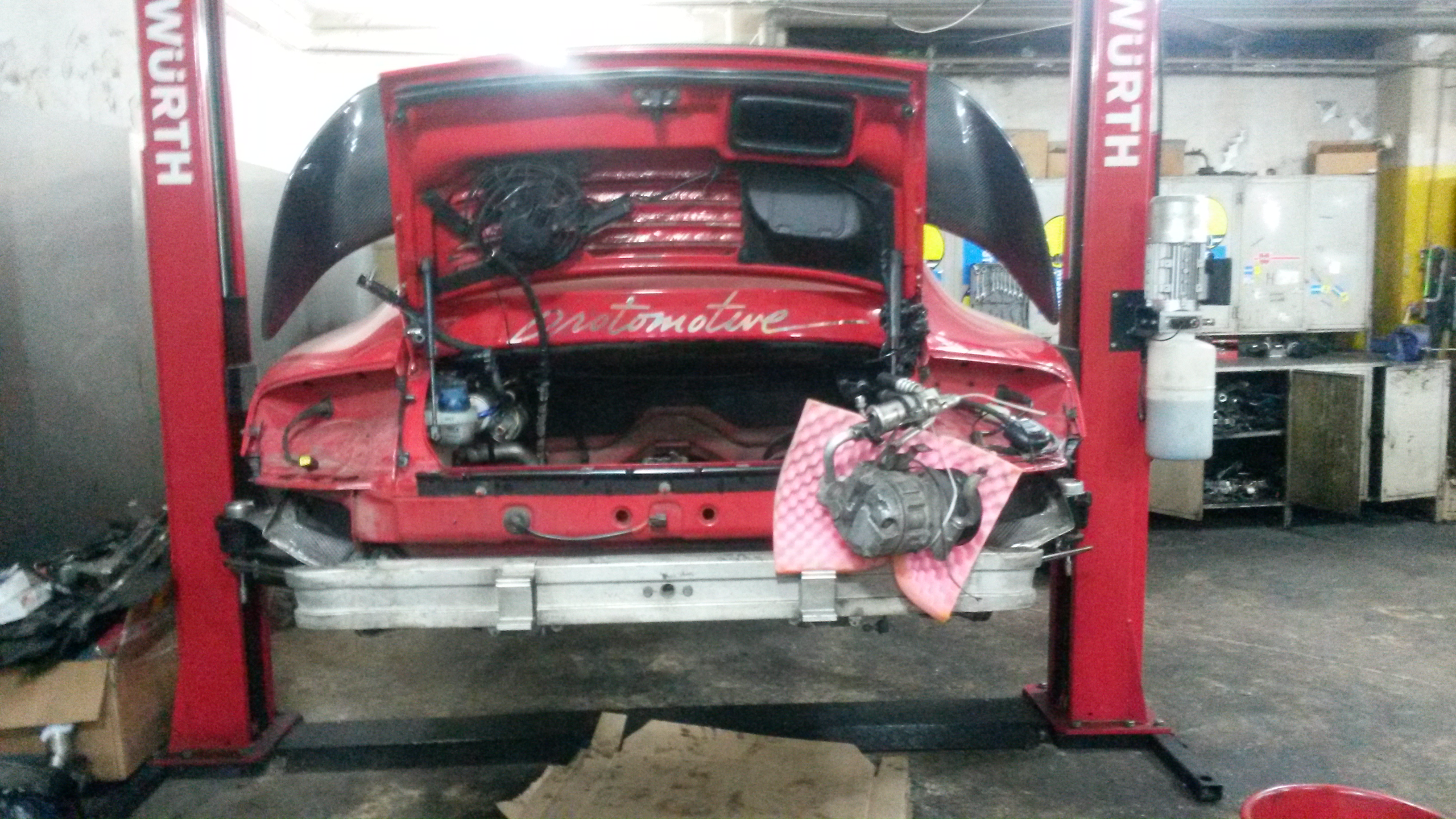

Today was a rainy day,nothing to do so i decided to go to my shop to remove the engine,it tooks me 4 hours to do it,first i removed the bumper,ICs,Exhaust and turbos,cooling hoses,etc... then removed the engine/transmission.
ID:	343851   Click image for larger version
