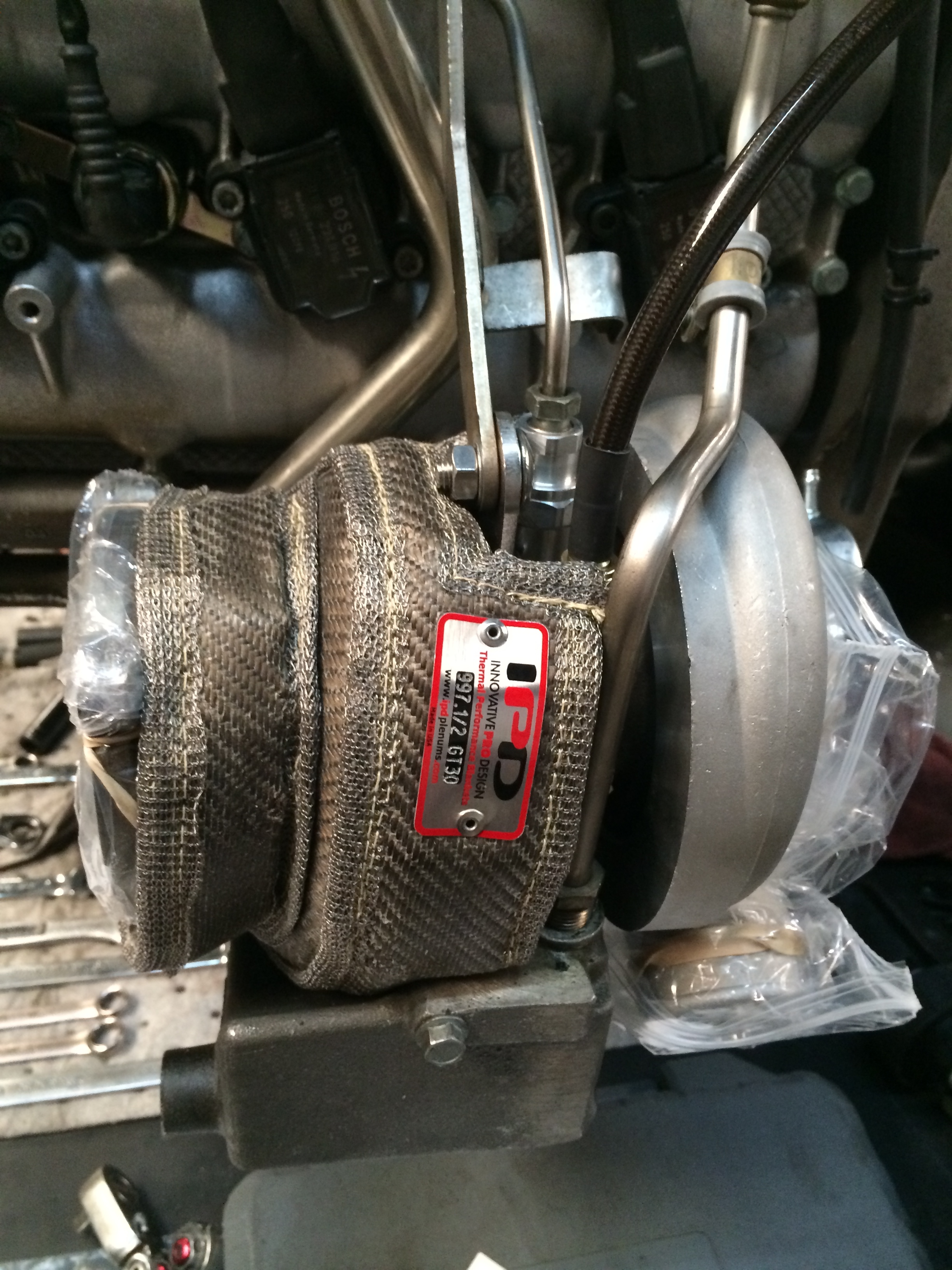

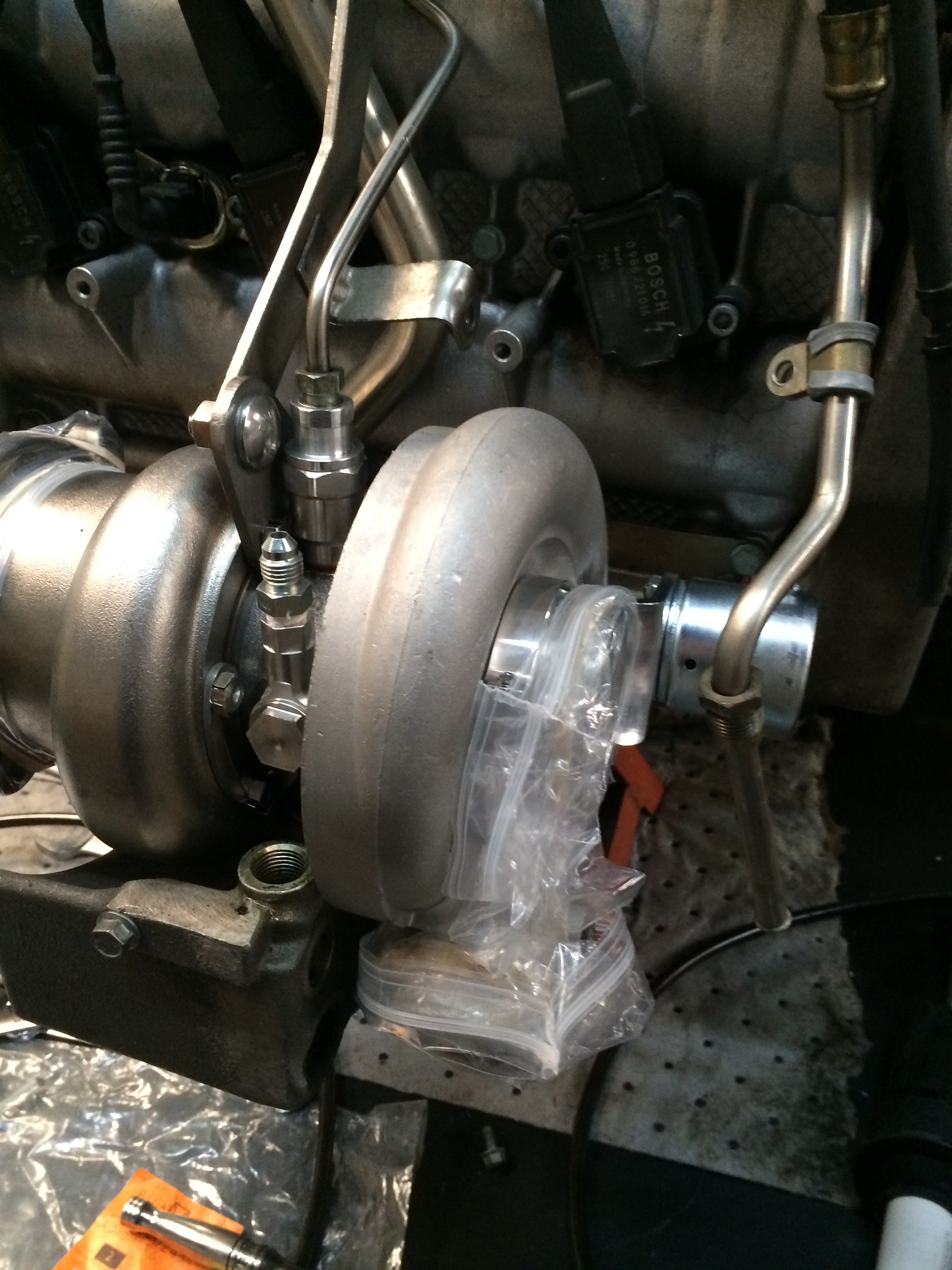

Old Mar 3, 2014 | 05:57 PM
32krazy!'s Avatar
Joined: Dec 2008
Posts: 5,551
From: tn
Rep Power: 628
just for you john!
ID:	341597   Click image for larger version
Old Mar 3, 2014 | 06:24 PM
johnspeed's Avatar
Joined: Jun 2006
Posts: 3,636
From: chicago
Rep Power: 256
johnspeed Is a GOD !johnspeed Is a GOD !johnspeed Is a GOD !johnspeed Is a GOD !johnspeed Is a GOD !johnspeed Is a GOD !johnspeed Is a GOD !johnspeed Is a GOD !johnspeed Is a GOD !johnspeed Is a GOD !johnspeed Is a GOD !
Originally Posted by 32krazy!
just for you john!
Thanks Buddy,,,now no sleep tonight.. LOL..
