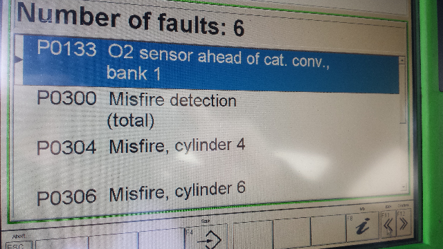

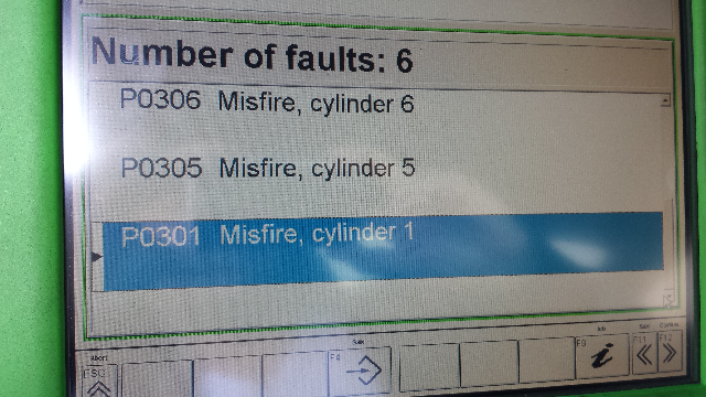

Originally Posted by ASLAN
Were the codes read???
Sorry guys its been a while but here are the codes I got when I scanned the car any ideas im thinking spark plugs and 02 sensor

[QUOTE=samyy;4072669]Attachment 349159
Attachment 349158
Sorry guys its been a while but here are the codes I got when I scanned the car any ideas im thinking spark plugs and 02 sensor[/QUOTE
Since this happened right after the purchase, I'd let the selling dealer deal with it. You could be throwing money at it. The cheapest thing on the list is O2 sensor but with multiple misfire, could be coils, spark plugs, injectors which you'd be chasing to diagnose.

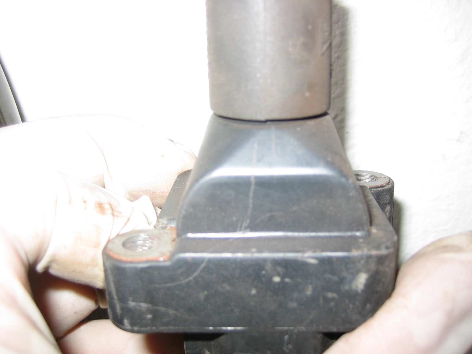

Great news that she is running good now! Hopefully you did a good inspection on your coil packs - those hairline cracks are hard to see. 5 out of 6 of mine had cracks when I did my plugs.
Name:	PORSCHE PLUGS-COILS-INTERCOOLERS 030.JPG
