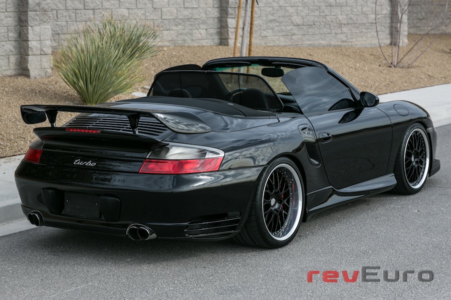

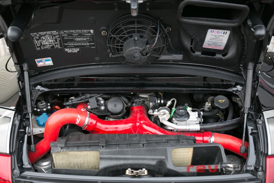

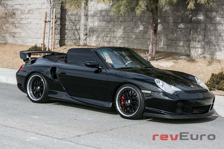

pictures of the beast

I would look into putting another air feed on the other side of your lid above the air box since its cut out on the box but you have no fresh/cool feeding into it there,,only hot air from the engine compartment..
Enjoy..
