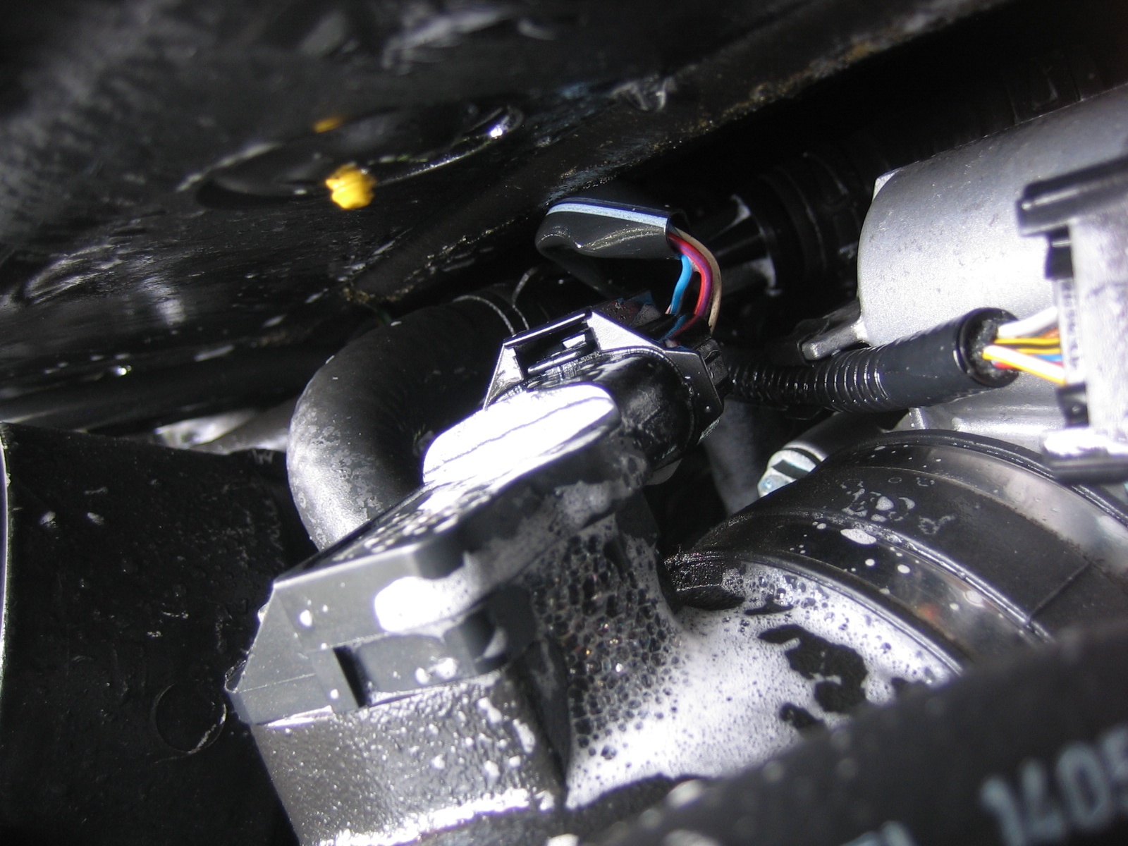

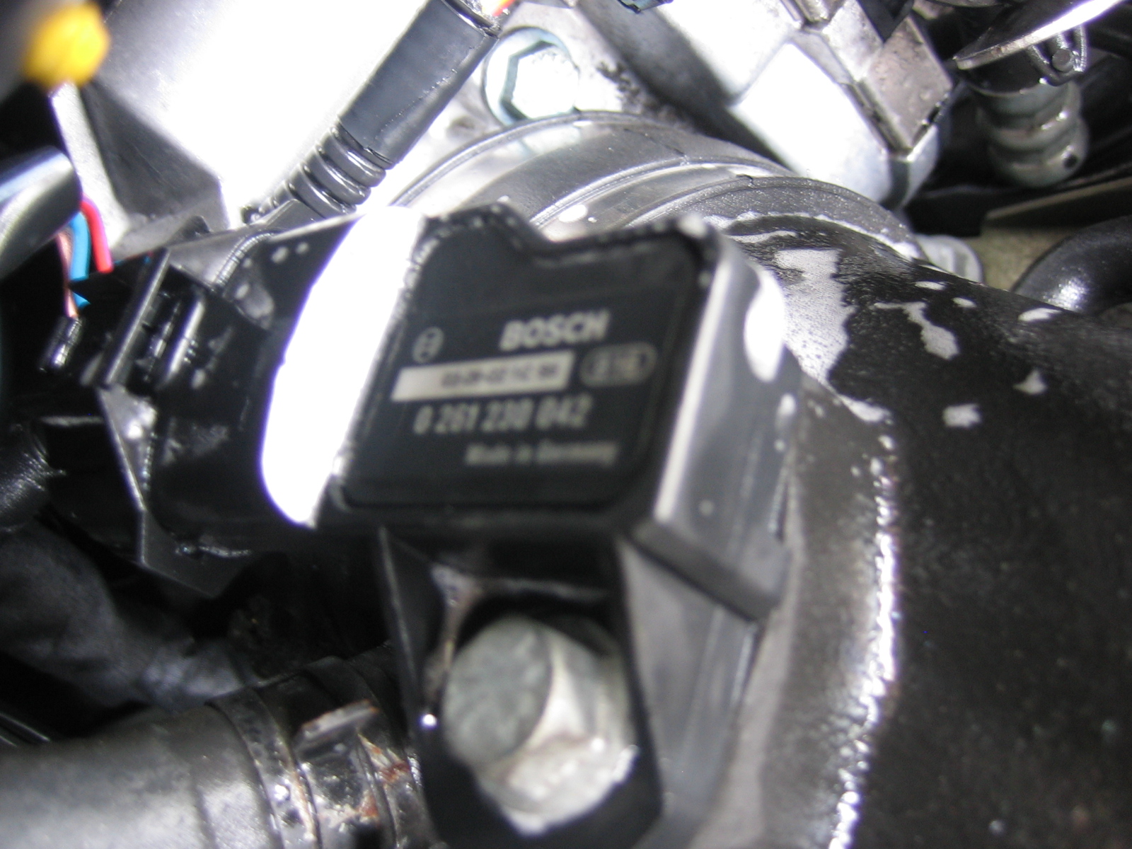

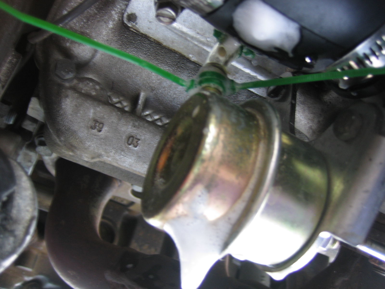

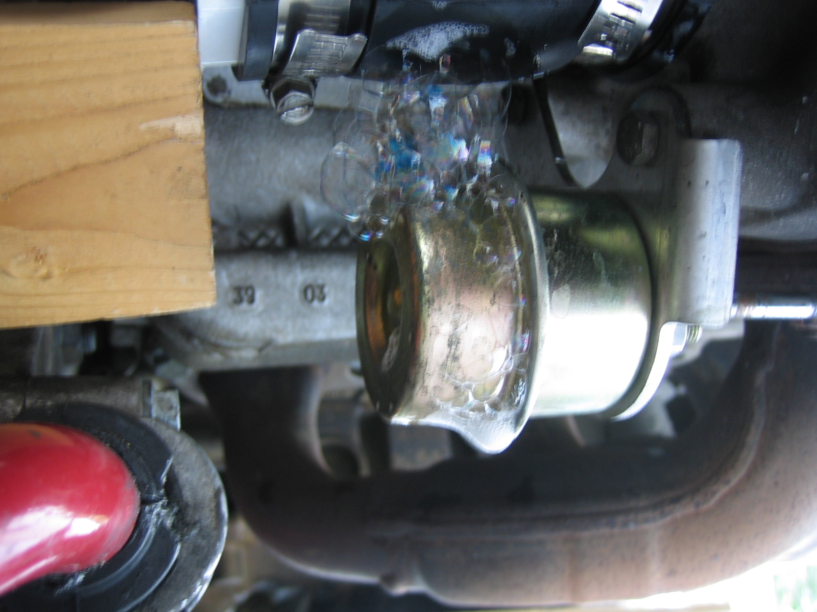

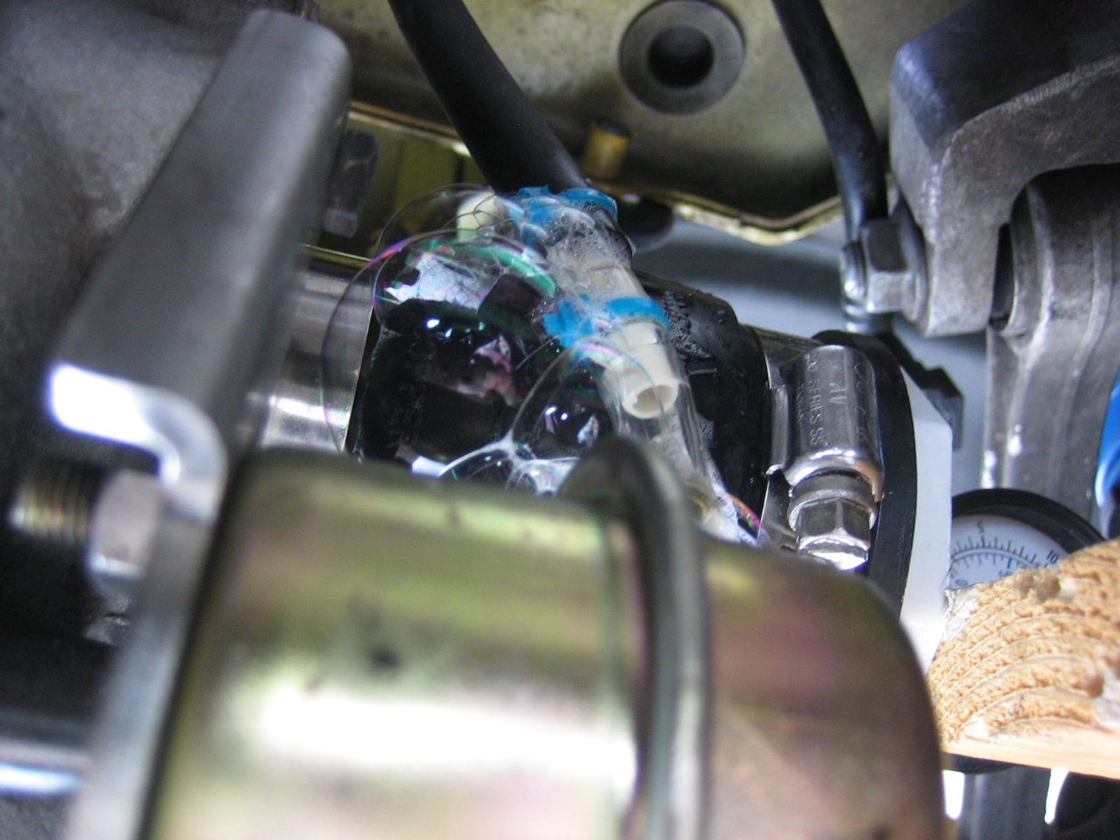

So, a while back my car was running somewhat rough and I finally got a CEL with codes 1109 and 1250. I read a lot of posts and found the 1109 pointed to the MAF, and I was so sure it was gonna be the problem, I preemptively bought a can of electronics cleaner. After checking the voltage, it read 1.01 off, and 1.38 running, so no issue there (I thought). Next up was boost leak check at the turbos. It wouldn’t hold air at all . Such a loud leak, I thought my compressor was leaking! I found the passenger side IC hose from the Y-pipe blasting air, so off with the wheels, bumper, and wheel well liners.
I had recently changed my IC’s to the GT2RS ones and obviously did not reattach that hose properly. I found the same problem on the driver’s side ! They are not as easy to seat as it appears! I recommend you really pull on them to make sure they do not pop off. They also do not seat as tight as I would expect, but they did hold pressure….until I pressurized my system to 15psi! At that point the passenger side IC hose leading to the Turbo popped off . Obviously the same issue upon reinstall after GT2RS’s! After I reattached that one, the system appeared ok.
The 1250 code is a boost issue, which could also be the wastegate actuators hung up, but my AMS WG’s were fine and the lines securely fastened by zip ties as I did when previously installing them. I ran the car with smooth boost and no issues, and the CEL did not return . However, the car was still running a bit rough, so I installed a new OEM Bosch MAF. This fixed the issue. So, a note to those of you who test your MAF and get “normal” voltage readings!
Fast forward to last weekend. While out on a spirited drive to enjoy the California weather (about the only positive thing left in this state), I noticed my bar gauge blip to 1.5 (normal 1.2) after a run to red line in 3rd gear. Having been informally educated by many on this site (Markski being the lead instructor), I immediately thought boost leak. So, back to the above procedure (sans removal of bumper), and on with testing kit at turbos!

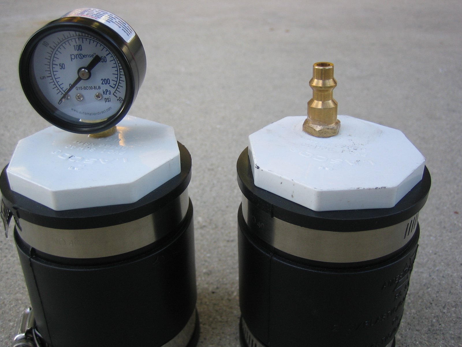

The attached photos show what I found at 10-15 psi: leaks at wastegate tubing on drivers side and a leak at the MAP (Manifold Absolute Pressure) sensor. I reinforced the tubing with additional zip ties. I removed the MAP sensor (screw secured with blue Loctite) and just did some cleaning around the area and connection points to the Y-pipe. I then slid the green rubber O-ring (shown in one of the photos) down (closest to the sensor itself). It has about 1-2 mm of play. I then simply reinstalled it, although I will likely just replace in the future as it looks like about a $20 part.
I retested the system and it held to 15 psi. Between 15 and 20 psi, the IC hose between the turbo and IC began to leak and I could not get it to seal . The gasket was replaced when I fitted the GT2RS coolers, so I guess I found the limit of the stock hoses! New Samco’s are likely in my future! I still have not fabricated a test kit for the air intake opening, or TB, but it is on my list.
In addition, I recommend supporting your test kit with a piece of wood between a point on the frame and the cap (you can actually see a part of it in one of the photos. That way, it will prevent the kit from popping off and, 1) scaring the bejesus out of you , and 2) smashing your pretty psi gauge (ask me how I know) or some other part of your car ! I hope this information is of use to some of you.
On a side note: I know Markski has been asked to post a video of what a “normal” sealed system looks like on the psi gauge. I know the system (at least from the turbos) does not hold 20 psi for minutes on end. So, here is another such request Markski!

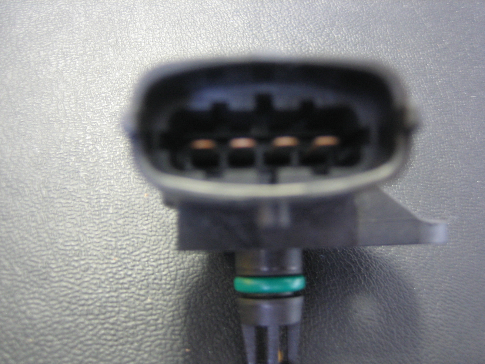

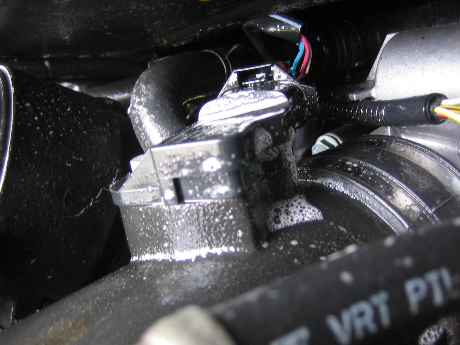

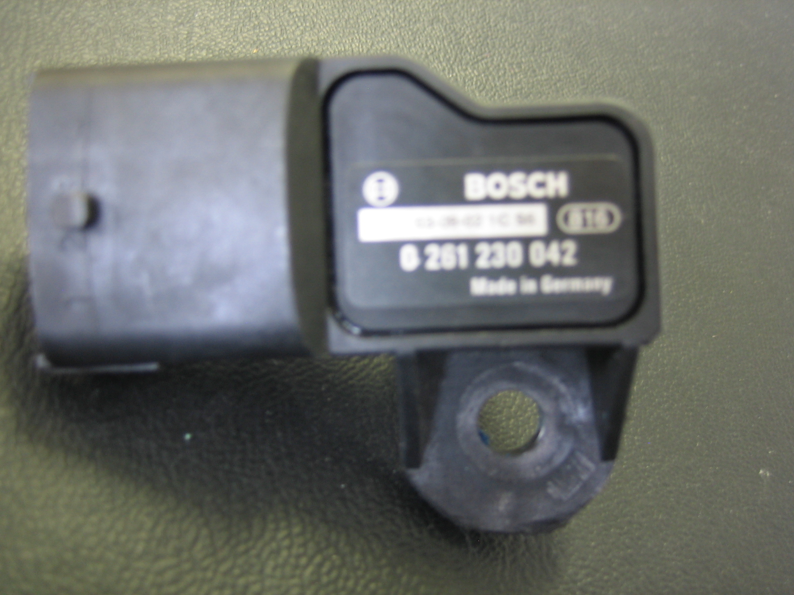

More Photos!
MAP Sensor!

Where and how does your MAP sensor leak?
MAP sensor sits right on top of the Y-pipe just before the TB. Check out the first picture in my second post. It's leaking right out the front (right) side, opposite the side with the screw. Single screw design could be better with a screw on each side IMHO. The last picture is the after shot - no more leak.

Originally Posted by ASLAN
I'm looking at the Forge ones. I have heard good things and they are almost half the price of the Samco's. I have also read good things about the new OEM hoses. My understanding is they made some improvements in design. Maybe someone can confirm this?
Thanks for that im very interested in knowing how you fixed the leak on the MAP? Thx
Sorry I was unclear - I just unbolted it, cleaned the area where it connects with Y-pipe, readjusted the O-ring and reinstalled. This made it hold pressure afterwards. However, like I said, I will likely just replace the part as it will probably leak again. Markski, have you experienced a MAP sensor leak? I have not heard you mention it much.
