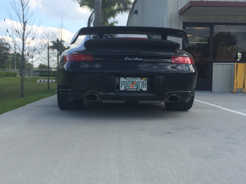

911tuning exhausts look great fro the rear!
