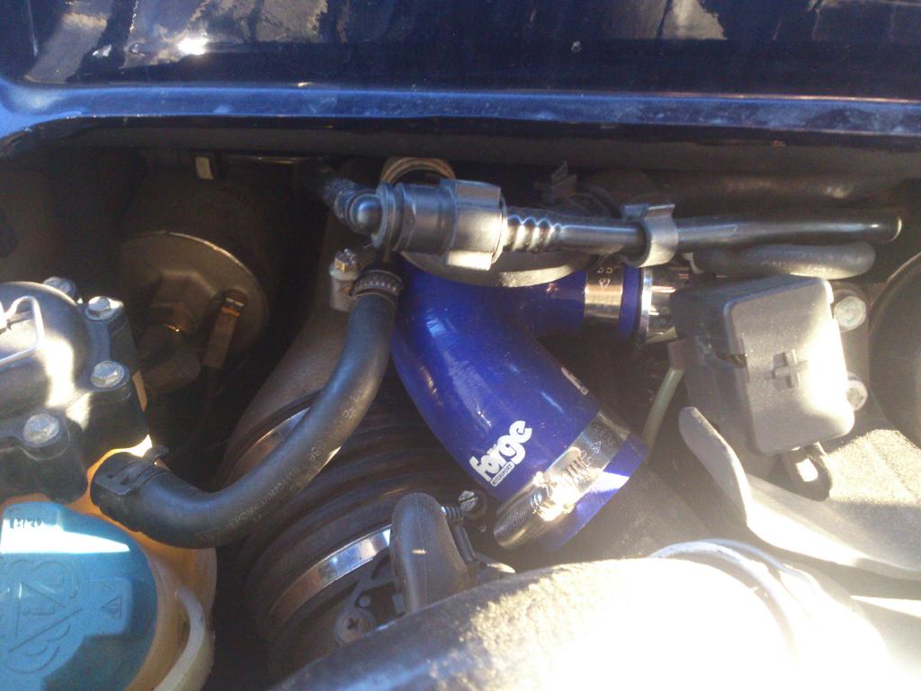

Here are some news from my car, not always good...
First of all I ordered 2 spring kits for my Forge DV. Yes, indeed, the green ones are for originale boost pressure and it was told to me, by many pro, that the good solution for me is to put yellow spring with the alumin plate.
So...
Order is made...
Waitin'...
We get impatient ...
And finally get the new parts...
"Get outta this Valve you dirty green spring!", "Got to hell" I said to it right in the eyes.
After 50 hours od dismaintling, about 12 liters of blood lost an some kilo of flesh less, we are finally able to put the plate...
and the spring!
Put it back together
And go ride for the test...
And then....
Nothing, always the same problem. I despair...
But I keep on searching...

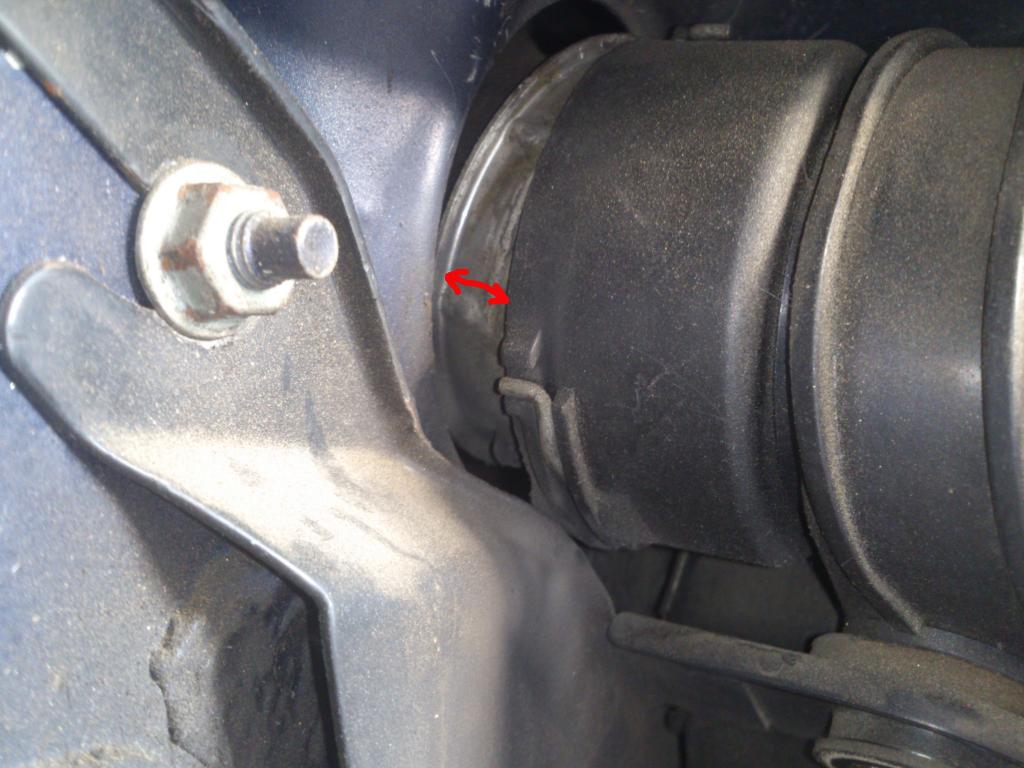

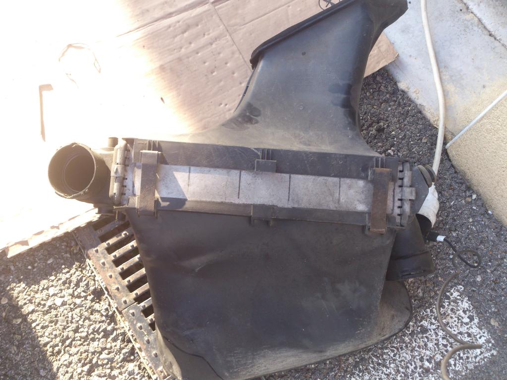

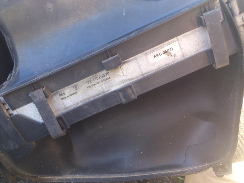

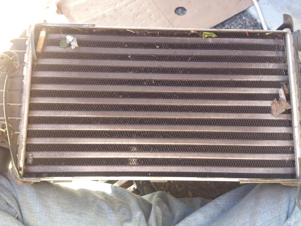

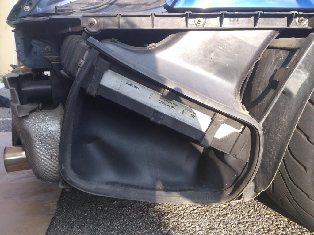

I decide to remove my rear bumper to check horses and intercoolers from turbo to plenum.
Ha! Okay, I understand now...
YYYEEEESSSSSSSSS! ENFIN! So that was the problem?!?
The hose is simply out of the outlet of the right intercooler
And to the inlet side, it's not better at all...
We can see the air way on the hose...
let's go again, I put it all together the good way.
And test!
The car rides a little bit better, I don't really remind how it was before, but I still ain't got the feeling to have 100 hp more... However, at last, I can have 1.1 b of pressure.
Now that the pressure seems to be okay, I take a appointment for the dyno test...

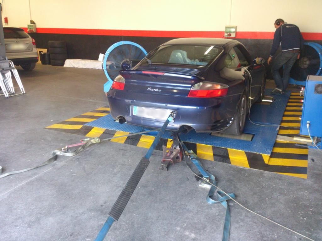

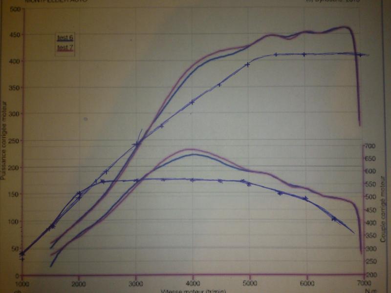

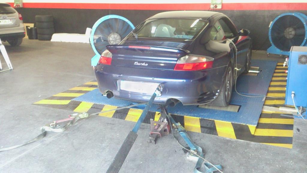

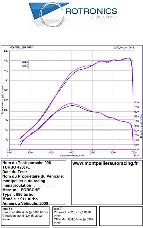

[quote="Clyde Barrow"]
Back from dyno test...
It comes as a blow, but not really surprised...
462 ch only, et 684 Nm...
Okay I had the "not all new" OEM air filter. But, anyway, at least 50 cv are missing! :P
The Lambda is good. The air/essence mixture seems ok.
The guy told me that the boost pressure went to more than 1.1b, but came down to 0.9, what is a lot for him.
However, if I compar to the FVD curve, I can see that power is missing all along the curve from 2000 to 7000 rd/min
Would anybody have an idea of what could make this? ...

the first place to check for a leak or popped hose is where they connect to the i/c's
they should have put that info in the owners manual, its so common

Reading your answers let me think I've been misunderstood.
-I had a boost pressure problem.
-I only had 0.8b max. as stock.
-I found the problem, it was, as shown on pictures, a problem with the 2 hoses "from" and "to" the intercoolers.
-I have solved the problem.
-The max boost pressure was good. 1.1b. There was no boost pressure problem anymore for me.
-SO I made a dyno test to control my power gain.

Clyde, I don't think you are misunderstood. But, I'm not understanding why a proper leak test has not been done.
"The car rides a little bit better, I don't really remind how it was before, but I still ain't got the feeling to have 100 hp more... However, at last, I can have 1.1 b of pressure...Okay I had the "not all new" OEM air filter. But, anyway, at least 50 cv are missing!"
I'm willing to bet you still have a leak somewhere! A proper leak test is quick, easy, and definitive! Also, from the looks of that inlet hose it has been dislodged for quite some time, sucking dirty, unmetered air into your motor. You may also consider changing to the updated (green) IC hose gaskets for proper seal.

Well, actually I was unsettling each part from the turbo to the Y pipe to test them all (that's the only way I know to find a pressure leak) when I saw the problem with the 2 hoses "from" and "to" the right intercooler. So, to me, it was THE problem.
When I replaced them the good way and tried the car, getting at last 1.1b, I thought that my problem was solved. That is why I went to the dyno test.
But the test let me think that there is still a problem.
Do you think that the good boost pressure for a stage 2 (510 hp) would be still higher than 1.1b? FVD never answered my question about this point...
If yes, do you really think that, only my used seals, could make me lose 50cv?
I'm gonna change them all, that won't be a bad thing anymay, you're right.
However, I'm surprised to see that when I compare the stock power's curve from the Porsche official book (drove with a blue pen on the picture) to my power's curves from the dyno, I'm less powerfull untill 3000 round per minute.
Doesn't it sound wrong with a pressure problem, knowing that the boost pressure really matters from 2700 rd/min?
I was thinking about, maybe, an ignition problem... What do you think about that?

You would be running a max of 1.4 bar with a stage 2.
Did you purchase the software from Pierre or someone else at FVD Germany. Just let me know and I will have them contact you directly.

I can reach 1.3/1.4b but only when I loudly accelerate in the last speeds (3rd, 4th ou more) from very low round per minute. By example if I do full gaz on 6th at low speed as 60 km/h.
If I simply accelerate every gearbox ratio one by one to 7000rd/min with full gaz (as for a run or race condition), I only reach 1.1b and come back to 0.9/1b in the very last range (from about 6000 rd/min)
Have I got to take the first example to compare my max boost pressure to your answer, or the second?
