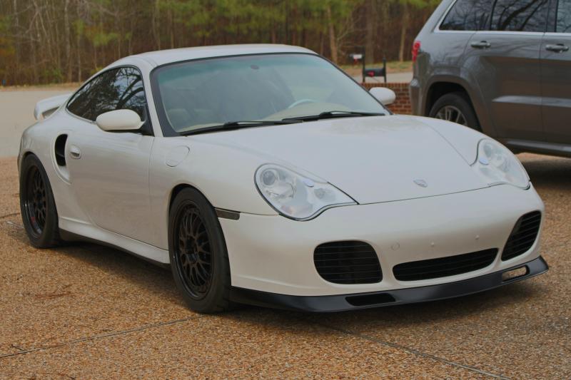

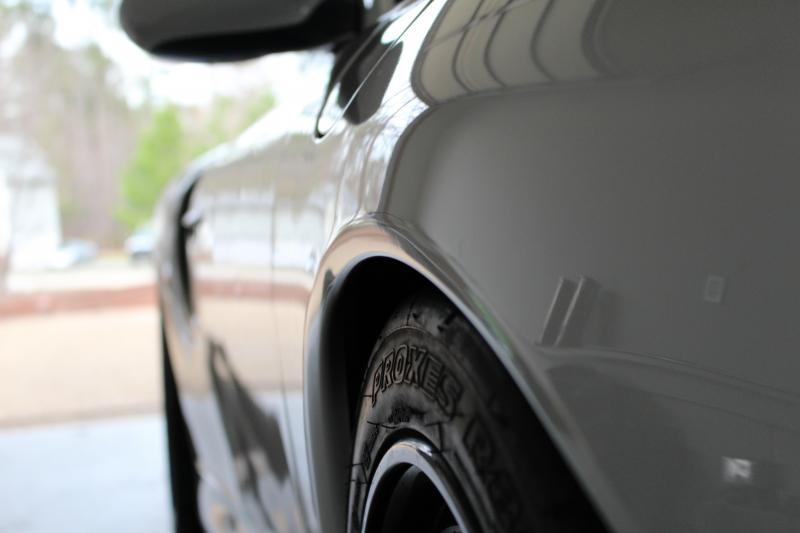

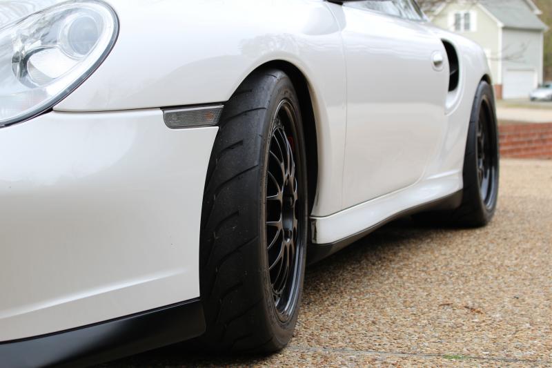

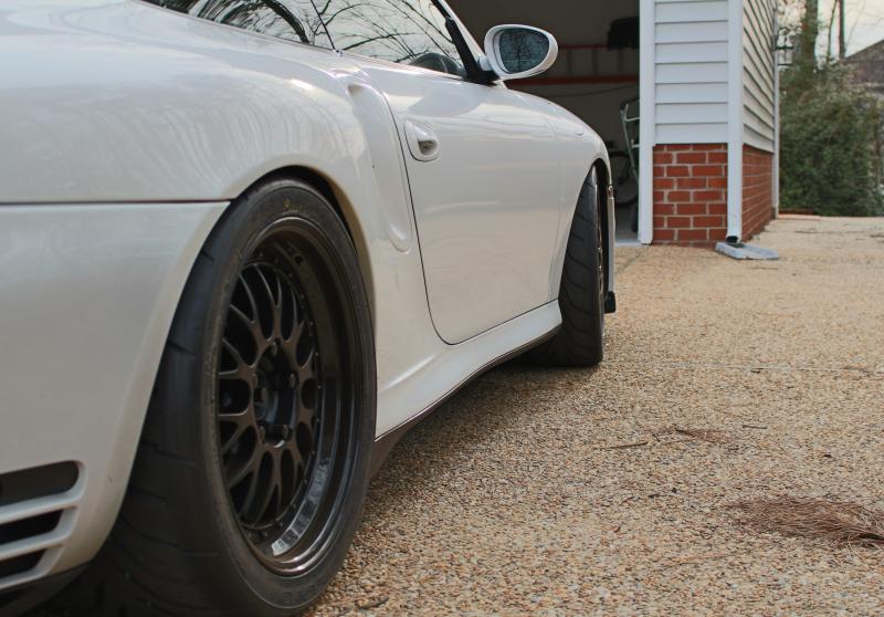

So, 245/40/18 and 315/30/18 R888s aren't exactly direct swap on the Turbo. However, after a little work they fit perfectly now. No rubbing at all. Rims are BBS E88's - 18x9 and 18x11 or 11.5 (was told they were 12" but the 315's don't look stretched enough for 12").
Thanks to pumalex for his write up: https://www.6speedonline.com/forums/...how-i-did.html
I spent an afternoon "massaging" the radiator brackets with a cutoff wheel and hammer and heating and bending the fender liners but was able to gain a solid 1/2 inch of room in front of the tires. Luckily the rears didn't rub the fender liners at all.
Even though it looked like I wouldn't rub the fender lips I decided to play it safe and have the fenders rolled anyway. I found a local Richmond, VA Cars and Coffee guy (Ricky Wilmoth for you locals) that came highly recommended from the community. He came out to my house and did a great job rolling the fenders. Having tried my hand at fender rolling before (and cracking the paint) I was very impressed with his attention to detail. Perfectly rolled and not a single crack
Took the car out for a quick spin and holy crap... 1000% better than my old Hankook V12's. The 245's in the front really make a difference. Still spin the wheels at WOT but I think it's because the tires are still new and greasy. I'm sure they'll get even better after some miles.

R888 won't look stretched on a 12" rim. I have that setup and it's a square sidewall with 315/30-18 on a forge star 12" rim

yeah you are right the R888s run wide and will def not look stretched at all on a 12" rim so do Michelin Super Sports.

On my 12" rears with 315/30-18 R888's, they kind of do actually seem a tiny bit stretched. The inner wheel lip is basically exposed... so if you lay the wheel face up on the ground, the rim is touching not rubber.
